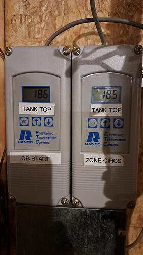

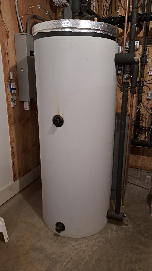

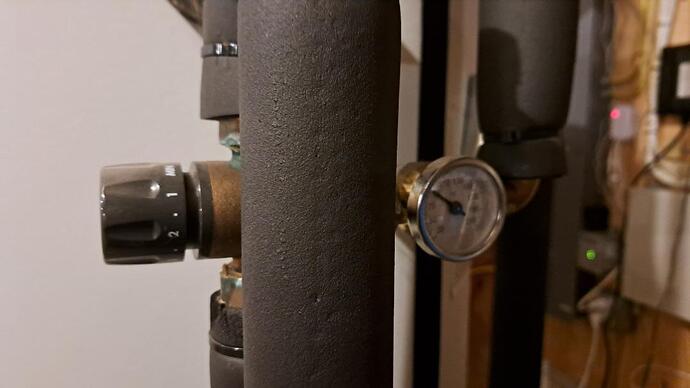

I have a high temperature buffer heat/dhw tank, that ranges in temperature from maybe 188-130. I have a mixing valve on it to supply dhw at the proper temperature.

Also, with a mixing valve you could run the water heater hotter and have more dhw capacity.

I don't know, but I went as eBay cheap as I could for three sensors on my buffer tank. Had to snake them under insulation. One failed. Didn't know which, yada yada. You only have one, so that's good. And maybe under some pipe insulation wouldn't be that hard to get to, unless it's in a crawl space, lol.

If you want to get more out of your water heater and have a constant temperature, consider a mixing valve, as I said. You can have your water heater at a higher temperature and then dial in the mixing valve to give you the temperature you want.
Here are some pictures of my buffer tank (for the pellet and oil boilers) setup:

I mostly heat with wood. I have an oil and pellet boiler, for which I got the buffer tank.
Now that I have a big propane tank for the generator, I could tap off of that and run a tankless water heater, I suppose. Capital costs though.
The buffer tank is well insulated. I feel that running the oil boiler for an hour or so to charge it up, is a good thing for the boiler.
