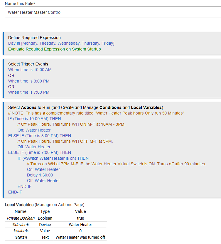

This rule saves a ton of money by only allowing the water heater run during off peak hours. You can modify to match your power company's off-peak/on-peak schedule.
It also has a "set it and forget it" feature to flip a virtual switch anytime during the week, and the water heater will come on at the off-peak hour (here, it's 7:00PM) for 90 minutes. This is nice if you think you'll need a shower in the evening and don't want to spend big bucks during on-peak hours (here, on-peak hours are M-F, 3PM-7PM).

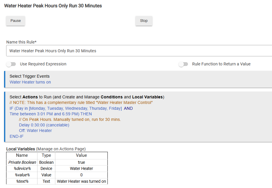

The second rule limits the amount of time (30 minutes) the water heater is on during on-peak hours, if someone manually turns it on between 3PM-7PM.
