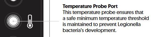

So I keep looking at this wondering IF and how I should accomplish it. I like the design and quality of product that Sinopé puts out and was looking at this:
When I noticed this feature that appears to insure (force) a "minimally safe temperature maintenance"

P.S. Your experience suggests that NOT using the Sinope min temp override feature would be in order to get the most savings. Curious why they put that in there, liability?

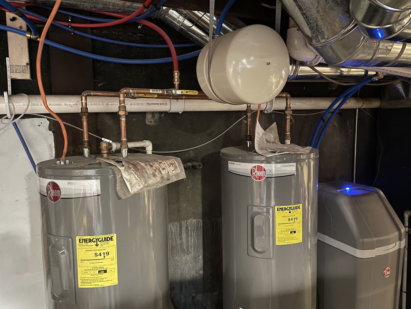

We run 2 75's in tandem (they both drain at the same time). You can see here in the pic that I built a manifold in which I can cut off either tank and remove in case a repair is needed leaving the house to run on 1 75....

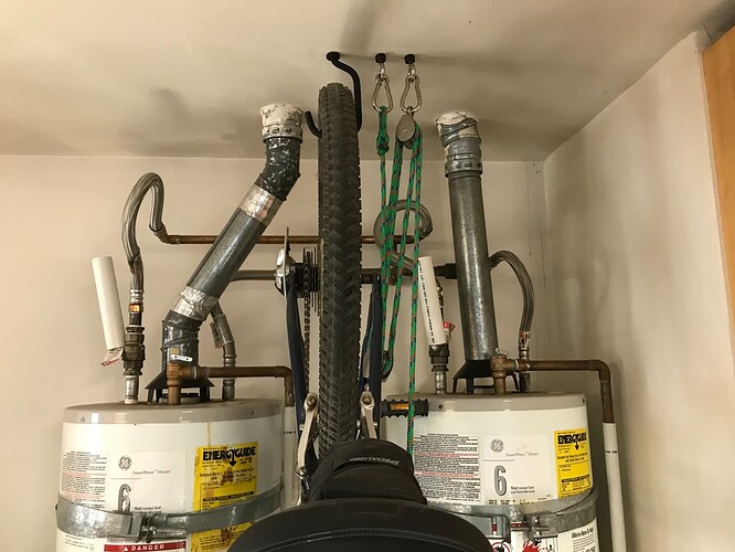

In the attic. Wow.
Basement
Whew. I thought someone said they had a tank in the attic.
I'm sure this is done where it's warm, but it's a foreign concept here in the NE.
Out west it's common to have them on the outside of the house.
I started out in tandem (parallel), but had issues with the balance- one drawing more than the other. Scaling would significantly effect the balance. I found series connection to be more reliable a connection.
Fortunately I haven't found that to be an issue.
Also plumbed in parallel for 24 years in current home with no issues, and 13 years in previous home with no issues.
But I am not a plumber so I don’t know the convention. Parallel does make more sense to me though as I can service one or the other while still maintaining function. Just my 2cents.
I've had multiple homes with the water heater in the attic... It isn't that uncommon in some areas - specifically ones that get cold enough in the garage you don't want to put them there, but also have a high enough water table that there aren't basements.

Our home is all gas and has 2 50's in a series on one side of the house and 1 75 on the other side of the house. The series pair made me scratch my head at first because I would have assumed parallel, but I did some reading and found that it is pretty common due to the mixing/balance issue. In theory, it should be the equivalent of having a 100 gal tank (and 2 50s is <$ than 1 75 gal typically - it's really a space issue at that point).
I emphasize in theory because in practice, I actually have to set the first tank significantly lower in temperature than the second tank or the second tank's thermostat/hysteresis gets confused and it never actually fires up - resulting in actually pretty lukewarm water at the tap/shower. I played around with this for a long time and the only solution I could figure out was to set tank 1 at A or slightly below and tank 2 at B or slightly above.
One nice thing about this setup is that I actually have the first tank off most of the time. It's really only necessary when someone wants to fill the jetted tub or we have guests in the house (the 2 50s only heat the master bedroom and guest room, the rest of the house is on the single 75 gal).
