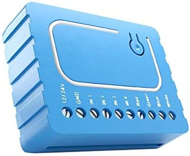

You might then consider the Qubino RGBW controller for the low-voltage side If you’re looking at color

Right now I'm thinking warm white by itself is probably best, which I'm still struggling to find a HE compatible dimmer / controller that will work. I'm guessing any of the RGB ones would work, and just use one channel?
It seems that way, but I’m certainly not an expert on the RGBW controllers. There are other folks here that have experience with them. I just didn’t think that I would ever use color most of the time, and it would just be a gimmicky wow factor for a few seconds Before setting it back to White, so I didn’t bother to put it in. My wife asked me if we could set them to a color right after I showed her the installation, but that was it, she’s fine with it not being anything but white
I am using the Qubino controller for my undercabinet strips. I don't need the rgb really, but I do switch it on rainbow during parties. The rest of the time it's on a cool white for cutting vegetables. I cut and soldered my own RGBW strips to spec so they fit all my cabinets sections exactly, and then secured them with clips. Used the 5-wire connector wires in between each strip. The Qubino is connected to a 10A power supply which is way more than enough, as there can't be more than 6ft of strips used.
Which strips did you use and have you had any issues? And the Qubino controller, does that mean you're using the driver from adamkempenich?
I don't recall which strips exactly, but they're dirt cheap out there - just look for analog rgbw strips and make sure there are 5 pads. Mine happen to have a weatherproof sleeve on them.
I did not know @adamkempenich made a driver for these, I've been using the Fibaro rgbw driver. I'll check it out.
Gotcha - thanks! I was just thinking... Can you assign the qubino controller inputs manually? Since I'm thinking of having 2 "zones" (under and over cabinet), I've been planning to have isolated systems so far, with all of the controls mounted in the basement below the kitchen. But, if I could use one power supply connected to one of those Qubino controllers, but then have two outputs going to each zone, that would simplify a bit and cut my costs. Just not sure if you can say "turn input 1 to 100%" and then "turn input 2 to 50%" simultaneously or if it just thinks they're different colors on the same string.
Edit: Actually, there are 4 inputs to allow 4 possible methods of control. (ie: switches)
So you'll have only 1 controllable RGBW strip, but you can use 4 separate switches to control the R, G, B, and W if you desire. There are some other scenarios it looks like.
Here's the manual:
If you're only using single-color strips, you could probably do 4 separate strips/zones, and control them separately using the R, G, B, W controls. Just treat each R, G, B, W as a separate strip.

This actually looks perfect - They say right in the manual that you can control up to 4 separate LEDs / strips with each channel, so I can get this one controller, get one power supply, and just branch out from here.
