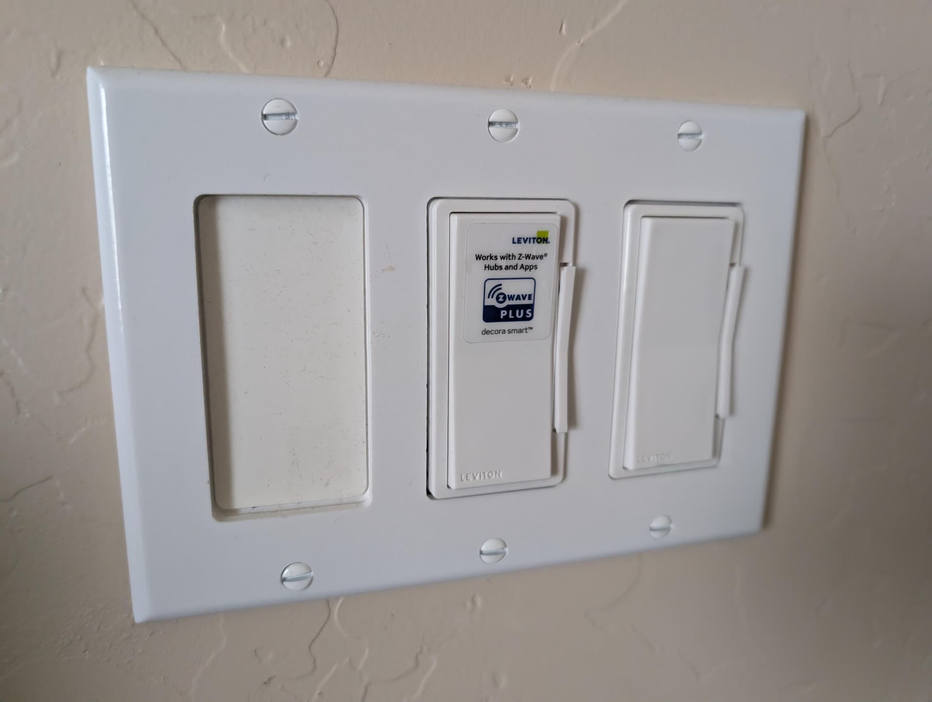

Take a look at Zooz ZEN34 & ZEN37. I love mine for similar tasks.
Get a wall plate one gang larger than it had. Screw the Zooz magnetic plate into the wall plate then put it back up on the wall, The image shows the Zooz maganetic holder on what is actually a two gang box. It hangs over but looks normal. (Tip, you may need to trim off two turns of threads from the plate screws. There is a provision for that built into some wire cutter tools.
