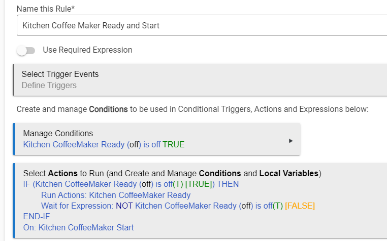

Recently I decided to add a second button and moved this rule from Button Controllers to the RM so, each button (old and new) can call this rule as a single routine. Now in the recreated RM rule "Wait for Expression" statement always fails. The good news is - the failure is 100% consistent.
Here is a related logs:
Log for the "Kitchen CoffeeMaker Ready" virtual switch shows the switch was turned ON at 4/20/2024 8:32:24.589 am by command Action: Run Actions: Kitchen CoffeeMaker Ready;
but "Wait for Expression" statement failed to see this Event (i. e. status change).
This looks like again race condition is involved because "Action: Run Actions: Kitchen CoffeeMaker Ready" statement turn on the switch very fast before "Wait for Expression" is waiting for the status change. However this rule never failed when it was created under "Button Controllers" but started to fail consistently (100%) after exactly the same rule was re-reated under "Rule Machine". This is very alarming behavior.

Sorry, but 10000% incorrect. END-IF must be executed after Wait becomes TRUE.
This rule was working flawlessly when it was created long time ago under "Button Controllers".
I know this phenomena very well. And yes, the workaround is to add a delay before Wait (done and it works). My point for the post was/is to warn a bit mainly new users. Without knowing a little details about race conditions new users could be very surprised to see this type of failures.
Exactly correct. And now I know very well what is going on.
