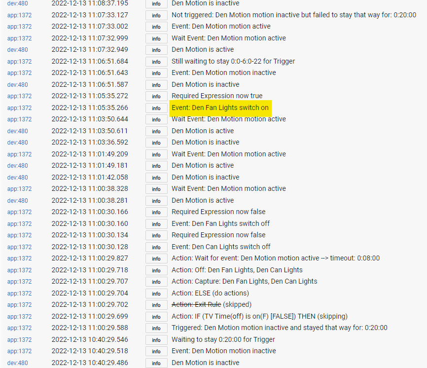

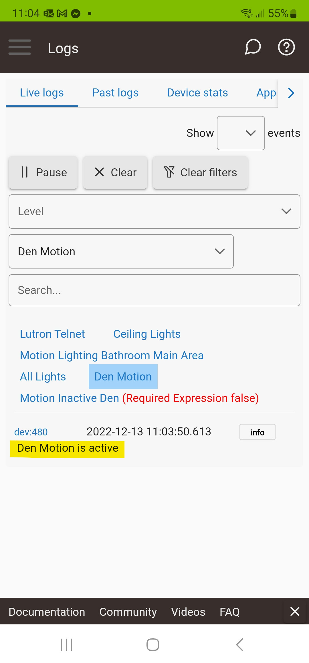

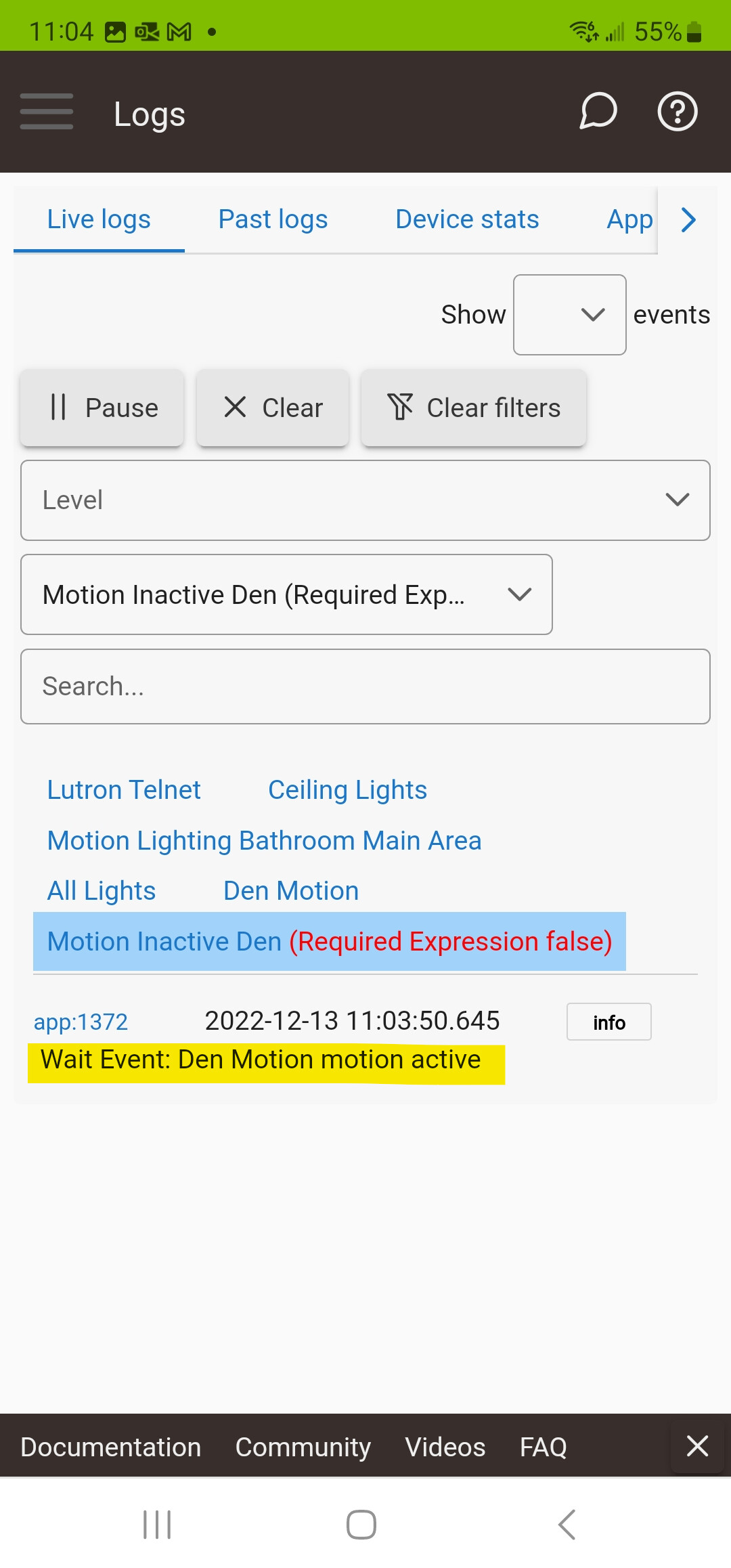

I think this is what you were asking about. I highlighted the part where I just turned the lights back on...kind of to mark the end of the thing. I tried to activate the motion several times before I realized it wasn't going to work.
This is earlier today when it worked correctly. This may not help, but I wasn't sure if you might be able to see something in it compared to the other that didn't work correctly.
Interesting. The only thing that stands out from those logs is that, in the instance that didn't work, it turned both lights off. In the instance that did work, it only turned off the can lights.
