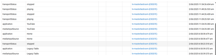

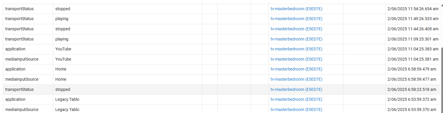

I have installed the Roku app. On the TCL TV there are two options in power savings, one turns the TV fully off and it takes about 30 seconds to startup and the other is a "Standby" we use the Standby and using off on the remote leaves the status of the TV in Hubitat as powered on.
Between 6:58 and 11:04 I powered off via remote and you can see there is no power event in the logs:
I have the outlet solution working pretty well now. Led's come on when power draw is 50 watts or higher, and turn off when below 50 watts.
