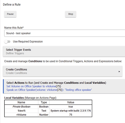

I have a Google Mini Speaker with a device label "Office Speaker". The "Speak" command in RM has a volume option that does not work on my system -- all sound is at the current Mini Speaker volume (set with its hardware controls). I have to add a "Set Volume" command to control the volume. Example:
Configuration: C-8 Pro hub, platform version 2.3.9.200 (ignore the %text% value, it's from testing a while back).
Is this a bug in RM, or am I doing something wrong?

The example rule as I wrote it works fine. The point I was trying to make is that you MUST use the Set Volume command because the volume option in the Speak command simply does NOT work by itself. That’s why I had to add the Set Volume command to fix the fact that the Speak command appears to be broken, at least with respect to a Google mini speaker.
