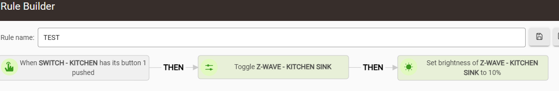

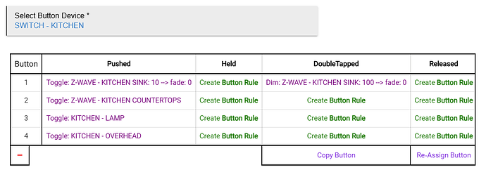

So I have a button controller for a sink light that has a fader.
I am currently using app < button controller. to turn the sink light to 10% with button-1
and have it toggle on/off when button-1 is pushed.
Can not seem to figure how to do this with Visual Rules Builder ?
Suggestions ?
I'm a bit confused what the ask is here - is your goal just to replicate this same switch behavior in VRB?
If so, why? This sort of thing is what Button Controller was designed for.

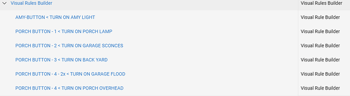

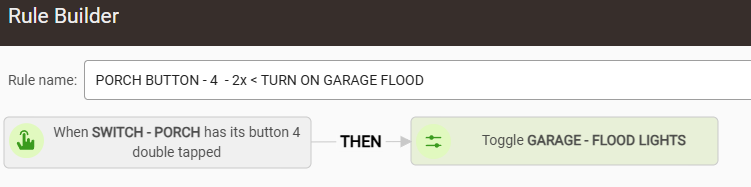

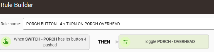

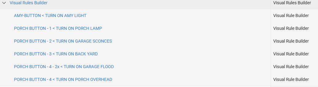

I did make a different one for the porch lights and it works very well.
I'm guessing VRB just may not have the same parity yet, but I admit I haven't installed VRB so I have no experience with it.

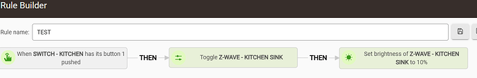

this does not work ..
Ok figured it out .. with the help of [csteele] and [bertabcd1234]
Looks like VBR is so basic you have to make ( 3 ) rules to make this work.
Rule 1. if button 1 is pushed toggle light
Rule 2. if light is on set it to 10%
Rule 3. if button 1 is pushed (2x) turn light on 100%
Anyway ,, just a experiment .. to see how / what to do .. make this work :slight_smile:
