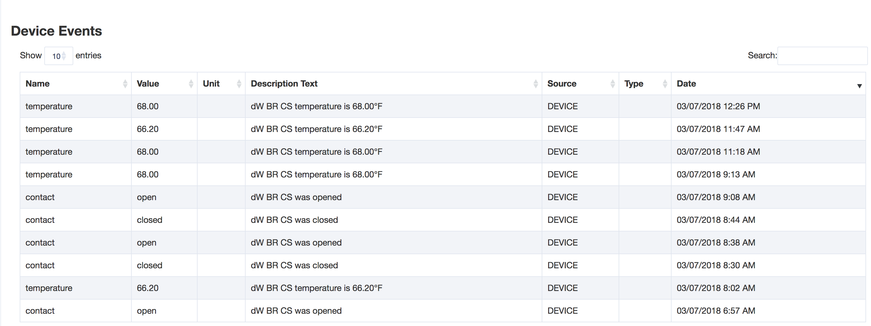

@Hubitat folks hooked up this contact sensor yesterday. i can see some events from the device but not all of the events seem to be showing up. like a few minutes ago i tried closing and opening the door but no contact event shows up in the device event log.
are there things i could check for why this may be happening?

Device events is not consistent but you can look at the device status while open/close the door and it's very consistent. I have a few of these sensors and they are very reliable.

nope shows open in device status when it should be closed. nothing shows up in live logs when door is opened/closed.
