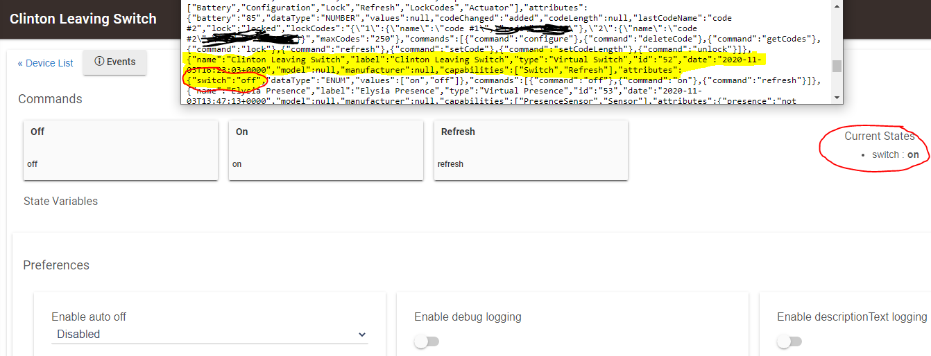

I am able to replicate the issue at-will now. I click a button on that sends the command with Maker API to turn the switch on, I watch it turn on in Hubitat. I turn it off in Hubitat, but it doesn't really turn off at all. Maker API says it is still on and if I refresh the virtual switch device page in Hubitat it will show as being on still....
Here is what I am doing to replicate what I am seeing; go to a virtual switch in Hubitat Devices. Go to Maker API where virtual switch is checked and providing an API and get All Devices with Full Details and leave that page open (I have that open in a different instance of the browser to make it easier).
Then, I simply turn the virtual switch on, refresh the API browser window, it will usually behave. Go back and turn the virtual switch off, refresh the API browser window. Usually, after 2 or 3 times, the API browser window will not reflect what the virtual switch status says and if I refresh the virtual device page it will reflect what API browser window says...it's like it "gets" the switch click and but it doesn't really get it and updates the status on the screen but doesn't hold it or something....
