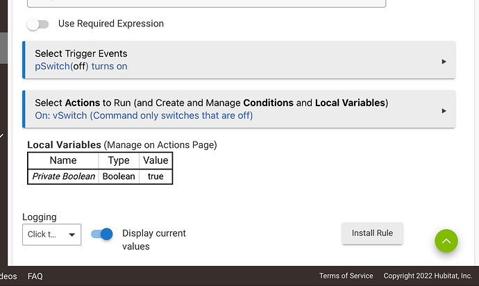

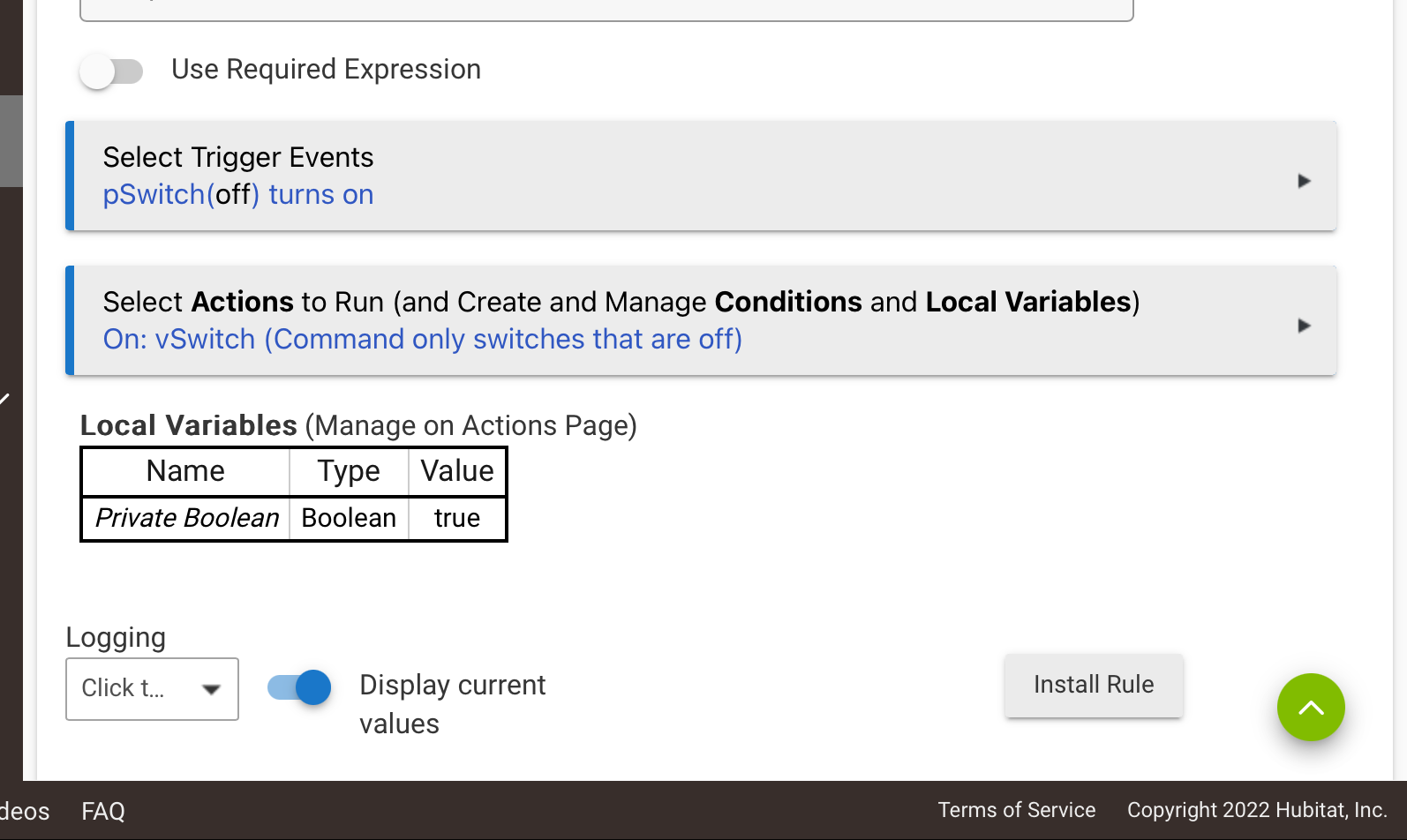

This is a Rule Machine 5.1 rule for a physical switch on to turn on the virtual switch, but the idea is the same for all 4 of the conditions.

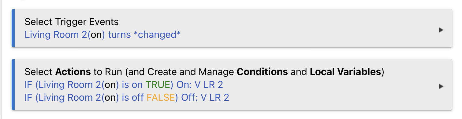

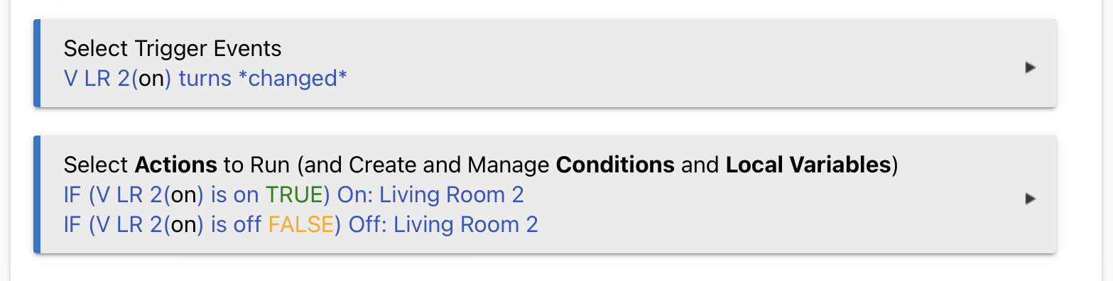

Thanks a lot for your help and support, I created the rules using simple conditioning action, had to create 2 different rules, the first is to control the physical switch from the virtual one,

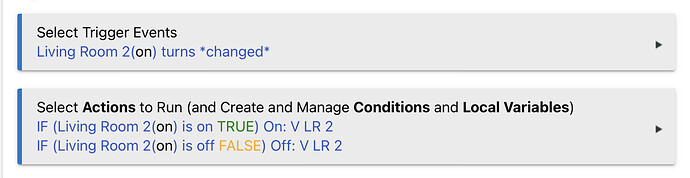

And the second is to mirror the physical switch states
