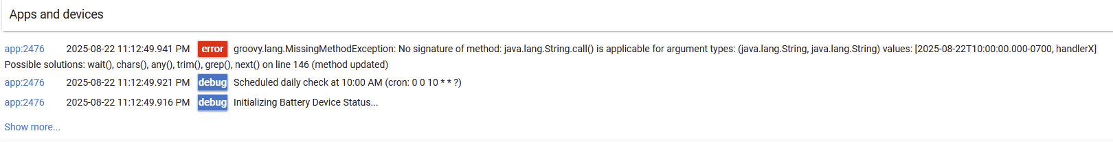

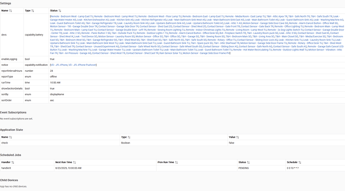

Very frustrating issue with Groovy code
I spent many hours trying to debug the code in the 1st section below; that code was based on a prior version I wrote that worked.
A "groovy.lang.MissingMethodException" error occurred with my new version that was always related to scheduling (see one version of the error in the 2nd section below). I tried MANY different ways to get scheduling to work, some of which are shown in the "initialize" method in the code (I commented out all but one of the attempts). That method should have worked with just a simple "schedule(runTime, handlerX)".
After comparing the code that threw the error to the prior version, line by line, I could find no reason the error occurred. So I started copying and pasting code lines from the broken app to a copy of the old app -- no errors. So I then copied and pasted ALL of the broken app to a new app (renaming the new app) -- and the error went away and the app worked.
In the 3rd section below is the working "clone". The ONLY difference between the broken and working apps is in the app name ("OLD" vs. "NEW").
Is this a known bug? And how do I distinguish between this bug and an actual programming mis-coding that throws a legitimate error?

Perhaps I am not following completely but it looks like you have a problem on the line below.
In the Error you got for whatever reason it looks like schedule was being called with a timestamp for the variable runTime instead of a cron expression as is expected based on Hubitat documentation.
Now that said if you are saying all you did was copy and paste it into a different app window and it saved then i don't know why that would work.
Adding to the above, the handler method needs to accept an "optional" Map as a parameter. I suspect Groovy will treat your signature as taking an Object instead, which should also work, but for your own sake, the data would probably be easier to work with if the type were consistent (example also in the docs linked to above).
The documented method of specifying the handler name is also as a String, though the platform will normally convert this to one for you if you just provide the method name like an object, so that's probably not related (but I'd go back to that code, which it looks like you commented out).
Neither of these is probably the issue, but fixing either can't hurt. :slight_smile:
Like @mavrrick58 said schedule() is expecting a cron expression. My guess is that the data changed. Looks like runTime is a preference setting which would need to be re-entered when you recreated the app, what did you enter in there the second time (if nothing then the if block wouldn't have executed)?
Actually after looking at the code a bit more, it does look like there is code to try to derive the cron expression, but the variable passed when calling "schedule" is the input value. Try changing your first variable in the schedule call to "cronStr" and see if that fixes it.
It's not a cron expression issue.
I literally tried about 10 different ways to write the schedule line, 6 of which are shown below (copied from the OLD code I posted, with comment slashes removed). Other variants I tried were with handlerX not in quotes (like the last example below).
  • schedule("${cronStr}", "handlerX")
  • schedule(cronStr.toString(), "handlerX")
  • schedule(cronStr, "handlerX")
  • schedule(runTime, "handlerX")
  • schedule(runTime, handlerX)
Note that the last line [schedule(runTime, handlerX)] works in the new code, AND in my prior working version of the code that the buggy code was based on, AND is the original code that I borrowed from the app 'Battery Notifier' by Bruce Ravenel.
And yes, ALL I did was copy and paste the old code into a different new app window and saved it after changing "OLD" to "NEW" in line 2. I still have both versions and the OLD version sill throws the error re the schedule method, the NEW version does not.

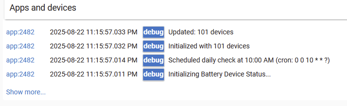

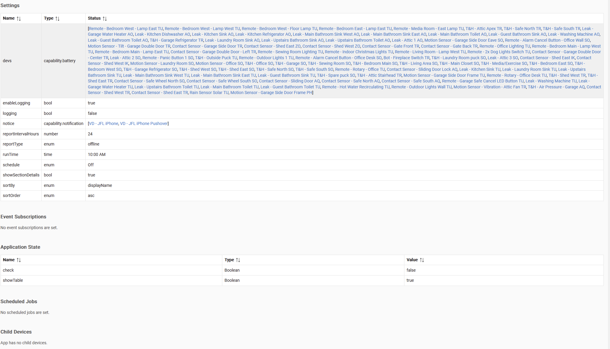

BTW, I replicated the problem this morning. I have a working app now, but left that alone. As a test, I copied and pasted the OLD buggy app into a new app window, changed "OLD" to "NEW" in the name, and saved. The OLD app throws an error and will not schedule, the NEW app does not throw an error and does schedule. So it's not a one-off thing.
Thank you for the suggestions! I'm still on the beginning part of the Groovy learning curve. That part of the code was just copied from the "Battery Notifier" app from Bruce Ravenel (see snippet below), and since it worked, I had no clue that it might not be strictly compliant.

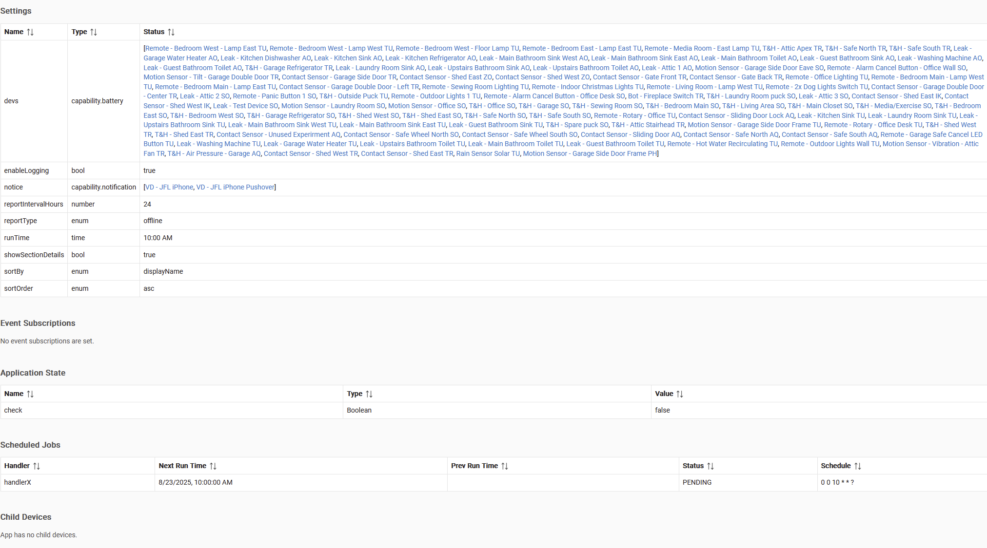

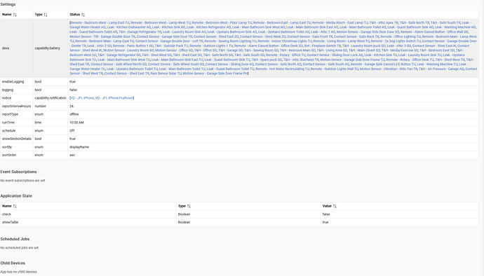

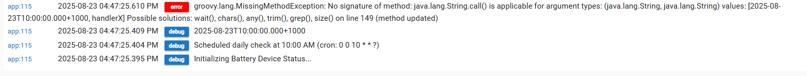

As part of my hour's long struggle with the buggy version, I did exactly what you suggest, and the cron string appeared in the log to be in a proper format. I removed that debugging code near the end of my efforts as being unnecessary.
I'm struggling to make it fail.... trying various combinations....
For an instance of an App that is producing the error:
  • I assume it is when you click Done in the App that the error is being produced?
  • Can you show a screenshot of the App Info page to see what values are being recorded and any scheduled jobs

I just ran the OLD version and here's the log:
For the OLD version, here's the app info page:

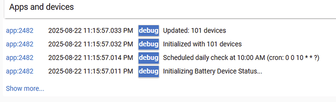

I just ran the NEW version and here's the log:
For the NEW version, here's the app info page:
Comparing the info pages side by side, there may be a clue: the OLD version has table entries called "logging" and "schedule" that the NEW version lacks -- but that might be because the OLD version fails at the schedule line.

Bingo!!
I added a test input called schedule, admittedly with a different type than ENUM (I just copied the runTime one). When I tried hitting Done, I got the error above.

Can only suspect you had at one point in time included a switch to allow you to turn the schedule on and off? With that setting persisting in your old App instance, but not being present in any new one's created with code that did not include this. Even if I removed the input from the failing code, the setting remained in the background and continued attempts to schedule the checks in the affected app produced an error.
Thank you! That seems to be the answer!
