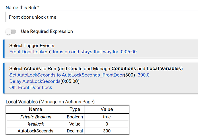

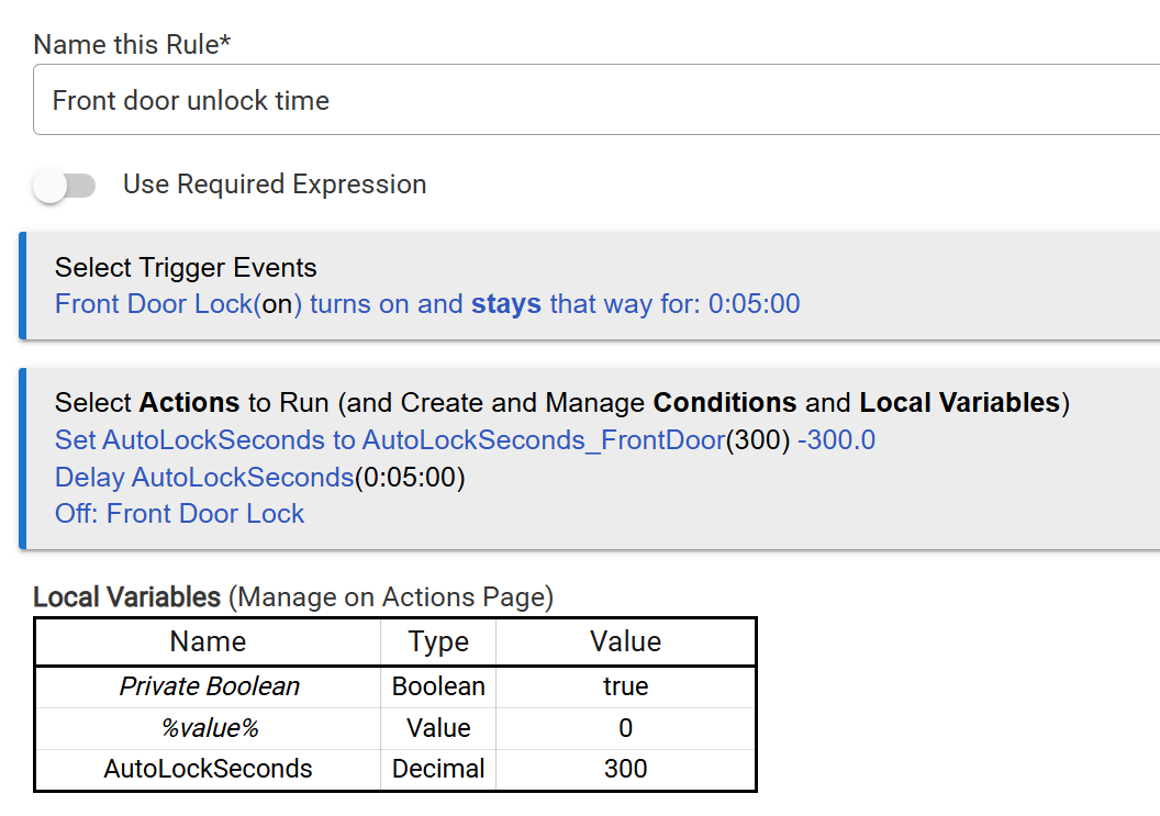

You can do this using a local variable and using a Delay/Wait command. Here's what I did:
You can use a minimum "stays that way for 5 minutes" and then set a local variable as a Global variable (AutoLockSeconds_FrontDoor) minus the fixed/constant amount (300 seconds) from the stays trigger.
This does mean your global variable should always be greater then the fixed constant (300 seconds in my example).
In my use case, it does allow to easily/dynamically change how long my front door stays open when unlocked using a global variable (AutoLockSeconds_FrontDoor) .
