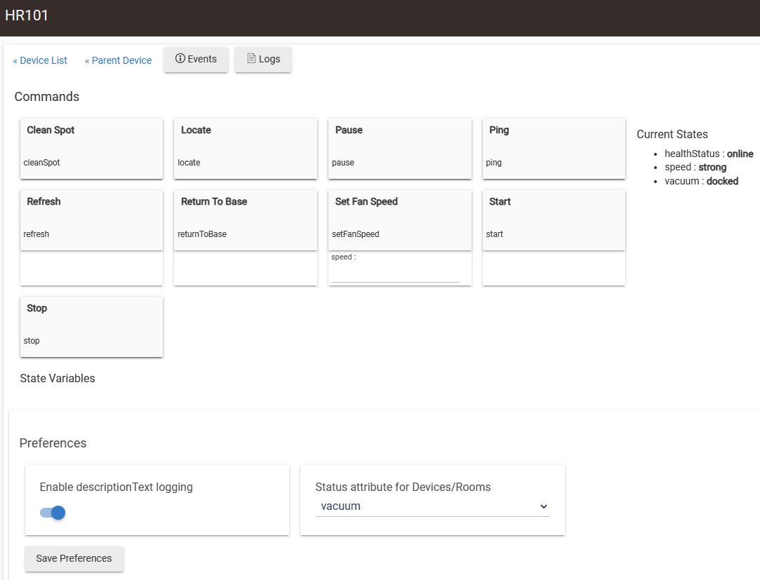

Since HE doesn't seem to have a driver for vacuum robots, what about a dashboard template for a set of commands to control one. I found that using the HA bridge driver, HE can now control probably most vacuum robots now. The only problem at this point is needing to create extra virtual devices (buttons mostly) to actuate control commands. The device already populates it's own controls. I was thinking of a template similar to a fan device where you can get a down menu of options to control it. Any takers?
Here's what HA has populated for controls for my own device:

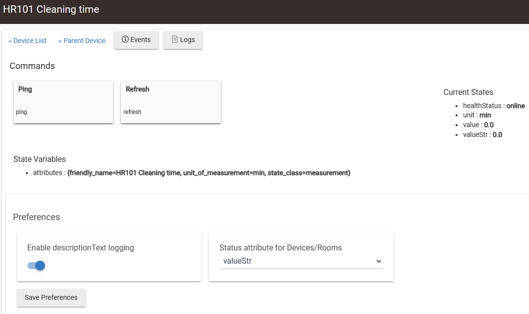

I also have an additional child device that includes runtime info:
