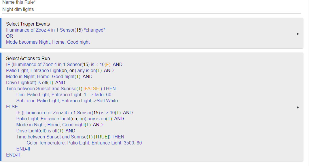

Hi so i have this rule, its kinda crazy but works ok
it basically dims outside lights when we turn off some lights lowering the light sensor...
but now i am going on vacations and i want it to be ignored and turn off or on either at sunrise or sunset like it always does.
You want to disable the entire rule “night dim lights”?
If so, here’s how to disable an app.
https://docs.hubitat.com/index.php?title=Apps#Disable_Apps
Do you use the built-in "Away" mode? If so, that should already prevent your first rule from running.

Or you could set up a separate rule to do this while you are away. A scene would be very easy to setup and capture, and then use that Scene Device in a Basic Rule or Simple Rule.

If you look at the first rule, you have MODE as a condition for both the IF and ELSE-IF. Since AWAY is not one of the modes that satisfy the condition, the rule won’t run.
I use the Mode Manager built-in app, along with our phones as geo-presence sensors (using Life360), to handle all Mode changes. When everyone is out of the house, the mode changes to Away and stays in Away mode until someone returns home. When someone arrives home, Mode Manager automatically sets the correct mode based on time of day.
oh ok i see what you say. but still also has the iluminance trigger
Sure, the triggers will still fire, but the actions will not run due to the conditions. No actions = no changes to devices.
