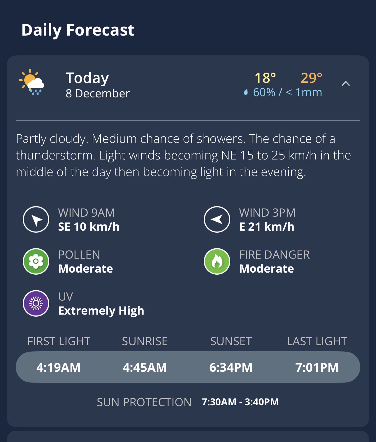

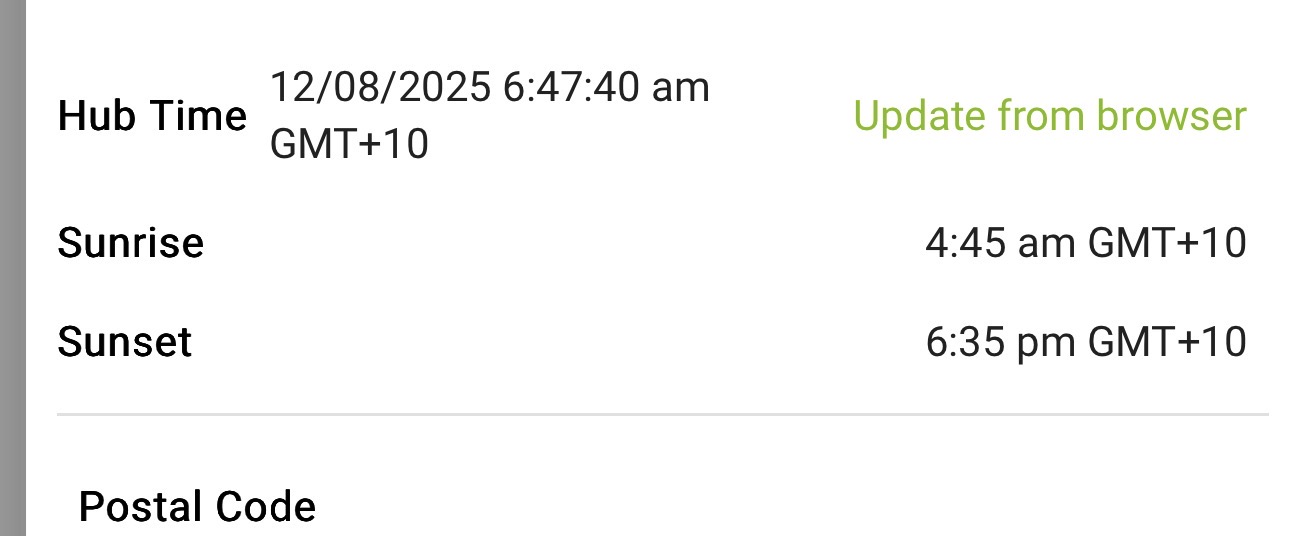

Mind if I ask, at 8:15pm your time, what time was sunset + 45min? Would love to determine if this is a bug, HE bug, or something else.
Edit: And THANK YOU for trying this out. I did this so just for me, as I've been using Alex Away feature for this over the last few years, but I really don't like that I can't tweak anything, and I like even less that it will fail if I loose internet. So wanted something local, and the now deprecated At Home Simulator didn't quite cover what I wanted. It makes me feel better if the time I've spent is helpful to others as well.
Sunset here is 6:34pm
I vote heck yes. Appreciate the contribution!
Huh, I trippled check the logic and simulated the times and I'm not finding a bug... yet.
