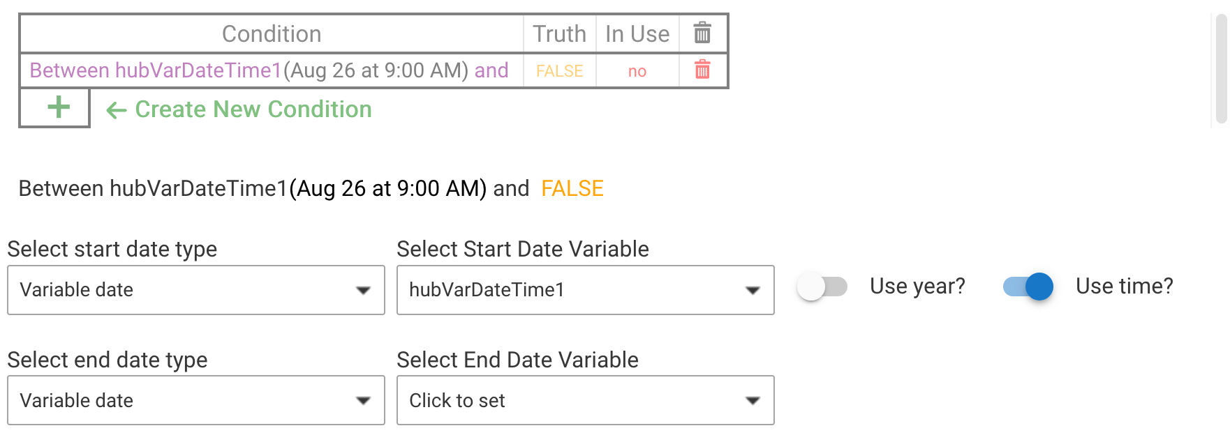

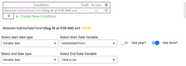

I'd create a second variable -- a local variable would suffice for this -- that you set to the current time right before the comparison, them compare the two as needed in a condition that you might start writing something like this:
(Finish this by using your other variable as the other half of the comparison, and use "NOT" somewhere, either the option you'll see at the bottom of this page after you're almost done, or separately in your expression, if you're really looking for the opposite, as it sounds like you are.)
This is assuming you're looking to test this in a condition somewhere in the rule. If something else, you'll probably need to share more about exactly what that is. Good luck!
Ahhh, the lightbulb moment the second I read your reply. I hadn't considered using a Local Variable and then using an Action to set it to current time. Thanks so much.
