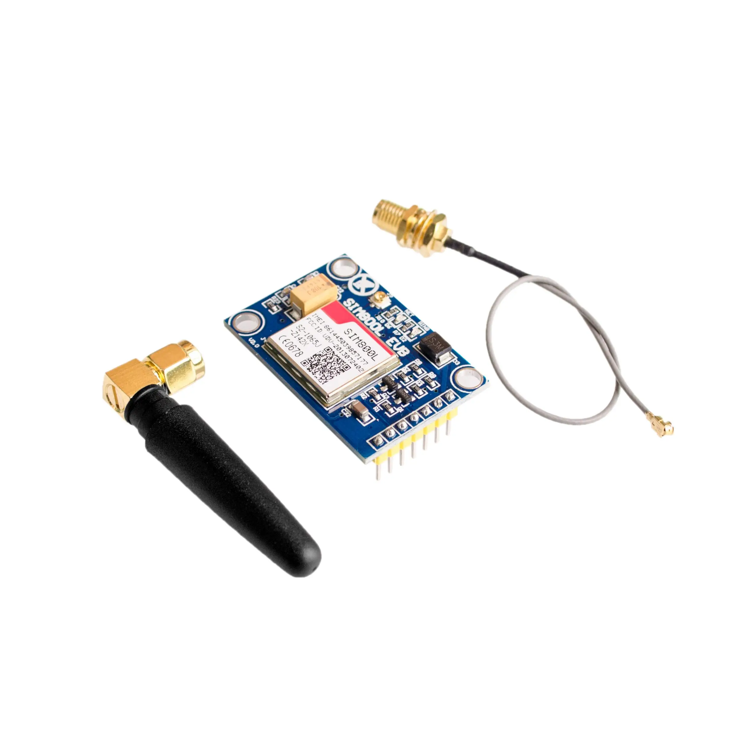

This is a different approach using an Arduino, lots of challenges but in the end it should be able to send notifications as well as receive commands via SMS.
