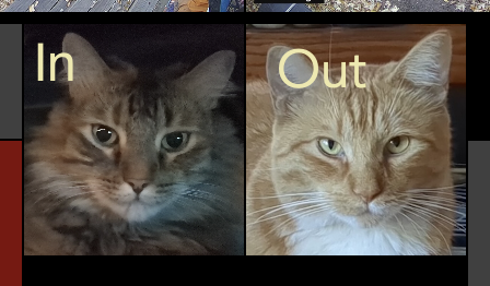

Here are the cat location tiles as I would like to see them only editing the code in each of these 2 tiles versus using multiple tiles/layers.
In-Out-Works
The text on the tile changes either by rule/s when 'something' is detected passing through the door or when tiles are manually selected to reflect In/Out status.
Present configuration uses virtual switch tiles. A virtual value tile overlays the top half of the switch tile. This pretty much works as long as the bottom half of the tile is selected. This can be somewhat problematic when using a wall mounted tablet running FKWB.
My self-imposed challenge is to be able to press the tile anywhere to set the location. I have accomplished this using a push button tile but that involves yet another tile layer.

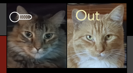

In-Out-HalfWorks
I have seemingly successfully edited the tile switch code so when the switch is "On" the left tile appears as in first image. Alas I have not been able to figure out how to edit/add code to reflect the switch being "Out" a.k.a 'Off'
Here is the CSS that is working thus far.

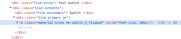

You should be able to use these for conditional css:
#tile-230 .tile-primary.on ()
#tile-230 .tile-primary.off ()

Maybe try:
#tile-230:has(.tile-primary.off) {}
#tile-230:has(.tile-primary.on) {}
Or:
#tile-230 .tile-primary i.material-icons.he-switch2:before {}
#tile-230 .tile-primary i.material-icons.he-switch2_flipped:before {}
I have not yet tried suggestion in your most recent post but it looks promising. I just noticed "he-switch2:before" when re-vsiting inspect elements. I had previously missed that. Thanks for your input.
