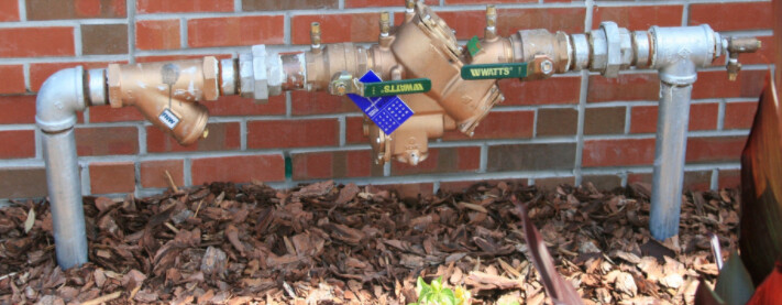

Many of us in newer neighborhoods also have backflow preventers to ensure sprinkler systems, etc, don't backup into the public water system. They are great devices for reducing public water system contamination, but the downside is that they are above ground outside and even more susceptible to freezing.
Example:
As expected mine froze up the first night the lows were 7 DegF - even with the water driping in all faucets.

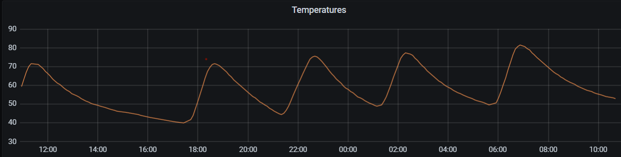

Results (graph from Grafana):
Note 1: I played around with a few different on/off temperatures, which is why the peaks and valleys differ.
Note 2: Oh, I re-purposed an existing motion sensor from my parlor... thus the name "Parlor Ecolink Motion" in the rules. I was in a hurry - no time to rename it. lol
