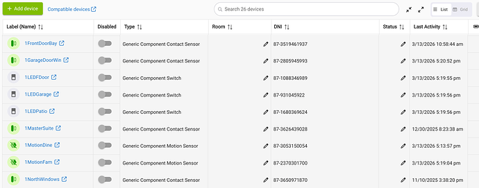

Hi, I am trying to create a rule machine rule that will send me the name of the contact that has triggered as part of the message. I assume it is some type of %variable% but I am unable to get it working. Any help would be appreciated. Below is the list of devices I see in Hubitat as reported by my Konnected system. Thanks!

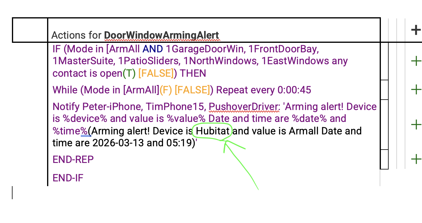

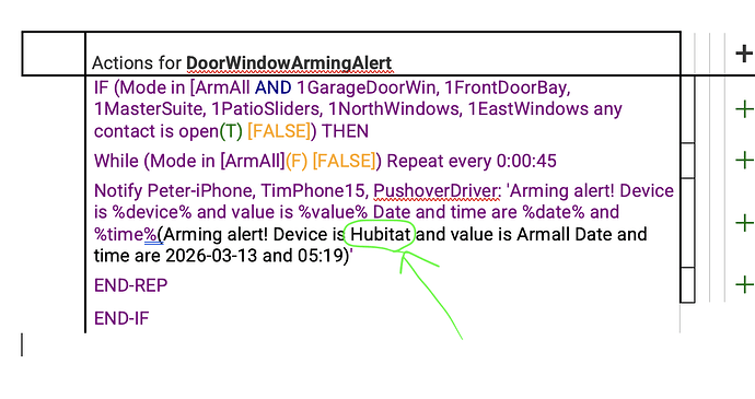

Hi Robert, what I see when the event is triggered is the name of my Hubitat device, not the name of the contact that has triggered the event. I am using %device% and expecting to see the contact that opened, not the name of my Hubitat system. Any suggestions?
We'd need to see a screenshot of your entire rule, including the triggers (and actions), to say more. But all your screenshot shows is that this was the value of this variable the last time your rule was triggered. Simply having a device as a trigger event for the rule doesn't change anything (e.g., if you've edited the rule since the last time it triggered) -- what matters is when it actually runs. You can read more about that in the docs, too; it's noted there since this is not an uncommon misconception.
If you still don't see how this could explain what's happening for you, I suggest enabling all logging for the rule (if you disabled it), then examine the output of Logs, filtered to just this rule, or share them here so others can see more.
Maybe this is a red herring in all of this, but that "...(T)[FALSE]..." caught my eye - that doesn't look right.
In both the IF and the WHILE stmt, it looks like you had numerous conditional elements at one point and then removed some of them, but not all of the corresponding parentheticals were cleaned up correctly.
Edit - I think the While stmt is OK... I'm guess I'm just stumped why there are brackets around ArmAll in the While stmt, but ArmAll doesn't have the closing bracket in the IF. Or maybe it shouldn't have the opening bracket :person_shrugging:

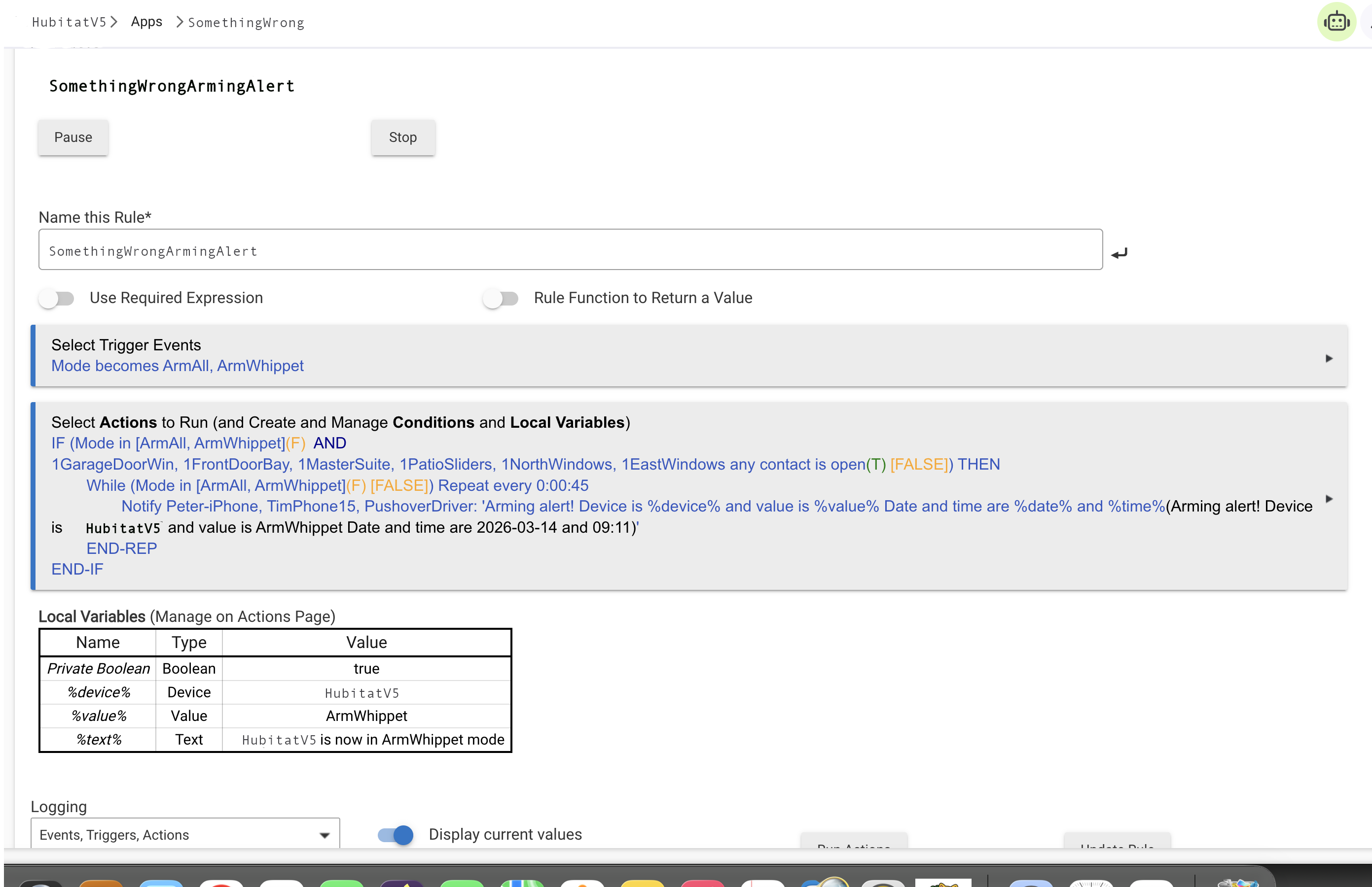

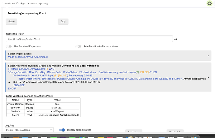

Thank you for taking a look at my simple rule. I use 2 modes ArmAll and ArmWhippet. FYI ArmWhippet is when my Whippet dog is home and I do'nt want the motion sensors enabled :slight_smile: What is happening is that the values being returned are the name of my hubitat device and the name of the current mode value. These can be seen in the code since I have toggled on the "Display current version" option.
What I would like the rule to report on is the contact sensor (Which window) and the current status (open/closed).
That rule is working as documented: the device variable refers to the trigger event. Conditionals in your actions, contrary to what sounds like your expecations, do not affect these variables. (You can read more about what actually happens in the docs I linked to above.) Your trigger event is the mode changes.
