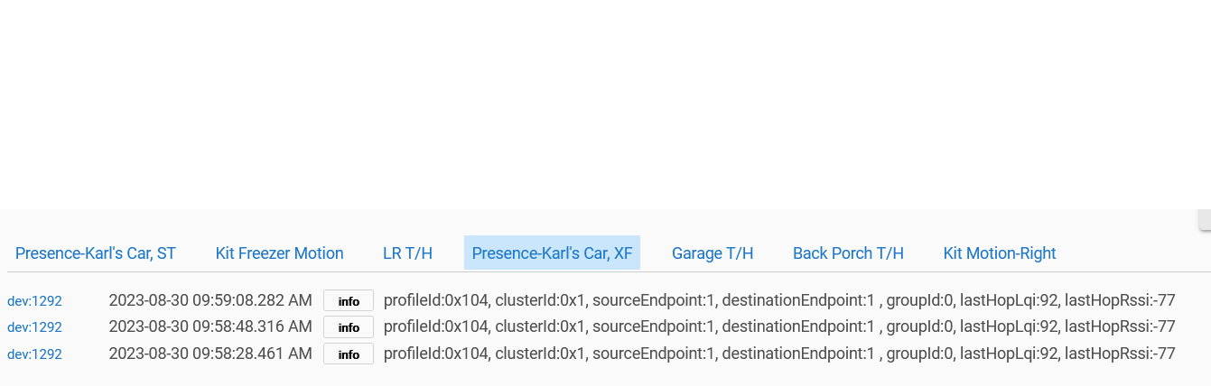

Check this out:
Zigbee log show it checking in every 20 seconds just like the ST sensor!
The driver is key!

The signal from the Xfinity might be not as strong as the ST.
edit: That's not right. It's stronger! Lower number = stronger!
Lot of variables though. Position of sensor, garage geometry, metal, etc, but should be similar for both.

Lower is stronger! So the Xfinity is stronger than the ST.

Well, look at that. The ST arrival sensor shows departed.
The signal was indeed weak.
I've been having some issues with getting a strong (enough) signal for the ST sensor inside the garage.
I did place the XF sensor next to the ST, so maybe that's a factor.
I'll move it around and see if I can improve it.
Perhaps the XF sensor's stronger signal will help with this.
