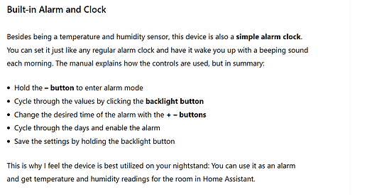

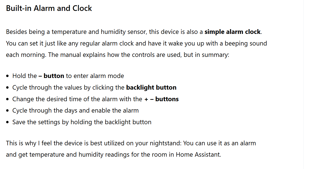

Google image search brought this up.
Tuya Climate Sensor and Alarm Clock JM-TRH-ZGB-V1 Review
Different model number but might be worth a shot. :person_shrugging:

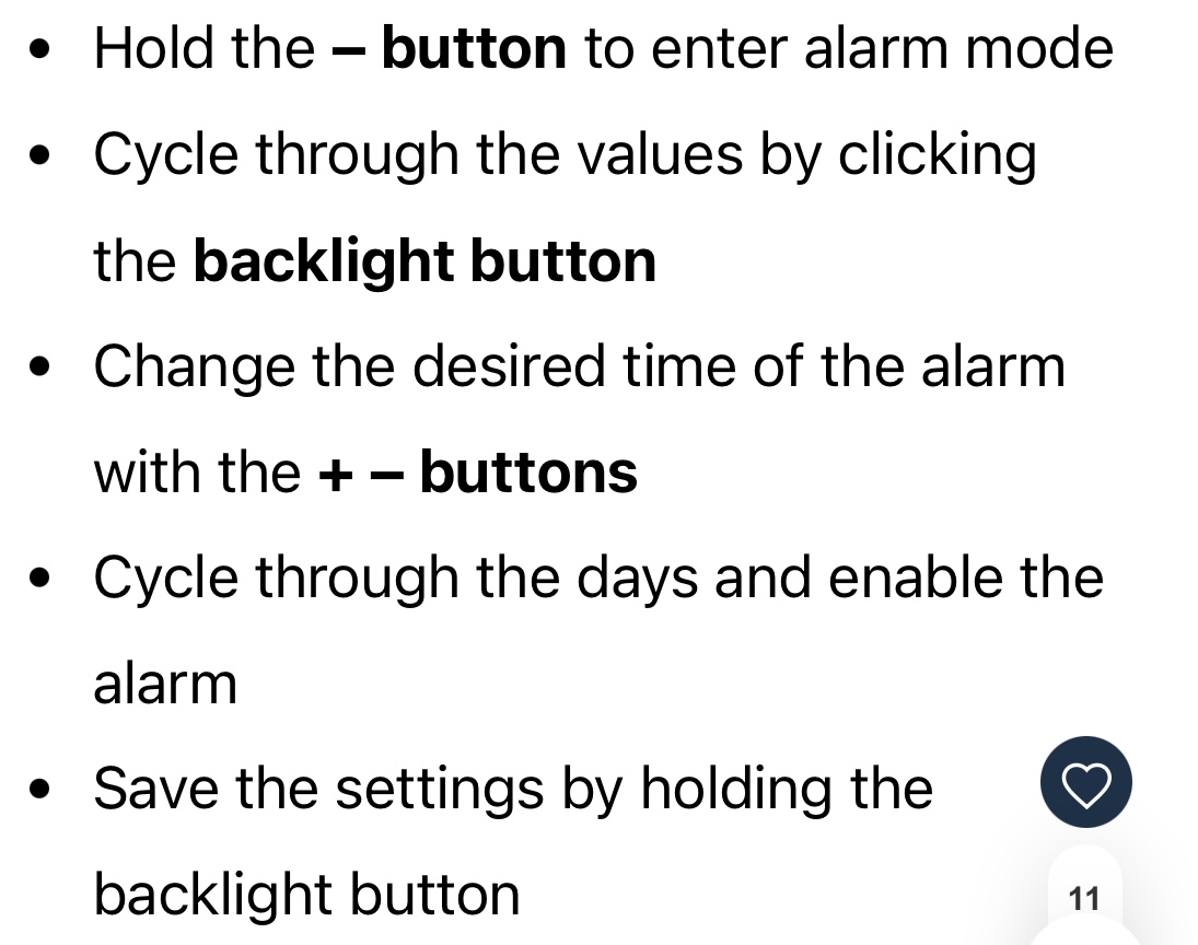

Bingo!
Thanks so much!
