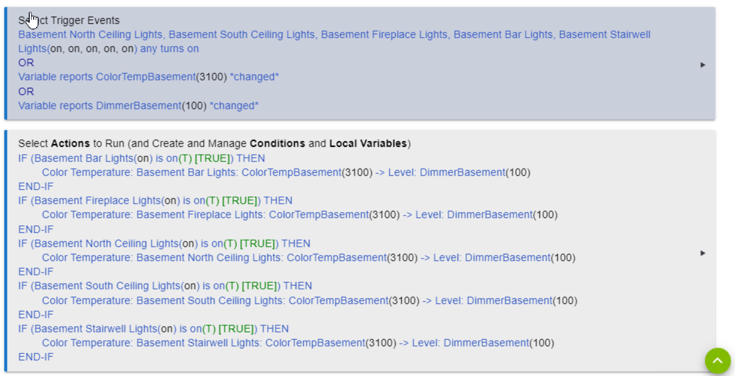

This is what I am doing now that I would rather be able to control at a Room level or even Zone level instead.

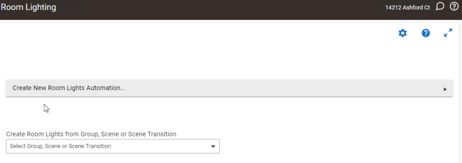

Right when I tried to create a new one, it is asking me to select room lights from a group, scene or scene transition. I want to select a room here.
Create New Room Lights Automation. Those others are for migrating old apps.

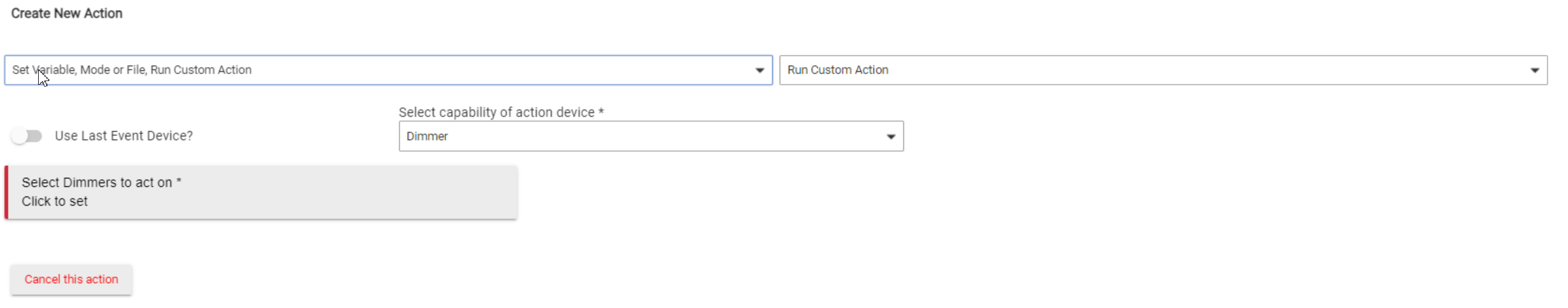

In the case of Rule Machine, this screenshot of a Capability based Action is what I'm wanting, but I want to be able to Select Dimmers based on things like Device Type or Rooms, not just Devices or Device Groups. Something where if I add a new device that was a selected Type or put it in a specific selected Room, it would follow this rule.
Yeah, I understand. A missing feature...
