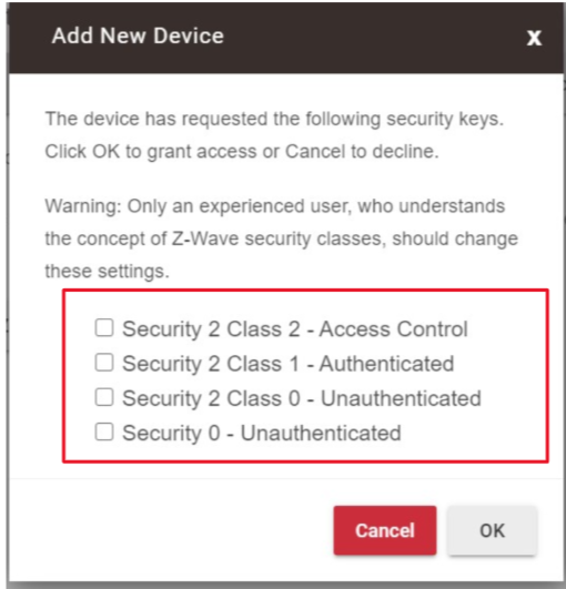

Hal - if you've lost the booklet and don't have the code you can join S2 Unathenticated, which does not require that you have the code.
If the Security dialog appears and S2 Unathenticted is pre-checked, you can unselect any other options that are shown, and leave S2 unauthenticated selected. Then continue.
Below is the Security dialog...is Security 2 Class 0 - Unauthenticated is checked when this dialog comes up, you can use it to join the blinds to HE. Just uncheck any of the other options that are checked.
If Security 2 Class 0 - Unauthenticated isn't pre-checked when this dialog appears then it is not supported and you'll have to use one of the remaining options. Do not use Security 0, the bottom option.

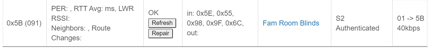

I excluded and re-paired my blinds this AM, so I could add them w/S2 security, which seems to be required for OTA FW updates.
I actually had to take the blinds off the wall and move them closer to the hub to do this. Though they originally joined fine from the window, I have been unable to get them to exclude/include from there since that original pairing.
So pulled them off the window and sat them down about 25' closer through an open doorway to the hub about 12-15' away. They excluded and paired from there successfully.

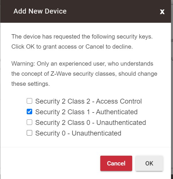

The only Security options the blind report support for are S2 Class 1 - Authenticated and S0 - Unauthenticated.
No ons should use S0 (older very "noisey" security that can fill up your mesh w/chatter), so uncheck S0 join w/S2 Authenticated.
Filled in the first five digits of the S2 code when prompted (the code is on the small instruction brochure that comes in the box as well as the bottom of the motor) when prompted and the blinds joined w/S2.

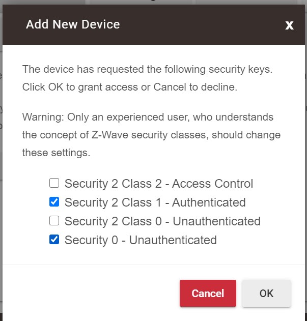

FYI, the hub will always use the highest security class you've granted, so in general there's no reason not to leave S0 (or any lower grants) selected when you've also chosen something higher. Checking the lower ones does enable you to use the device with another Z-Wave device that uses Z-Wave Association (so doesn't go through the hub) and supports only those classes, so if by chance you have something like an S0-only remote/button device you want to use to directly control the blinds, you'd actually want to leave that checked. But in most cases, I suppose it won't matter.
Unfortunately, the time where this matters the most--when you have an S0-only device that also doesn't have separate process to include it without security--then there's nothing you can do (without third-party hardware to join the device, I suppose), since you don't get this popup in the first place unless there's S2 at all. ![]()

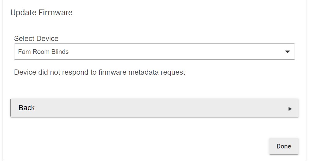

Also, I have been unable to get the 2.2.4 beta Device FW Updater to connect to iBlinds to try the FW update. It worked once on .134 or .135, hasn't been able to connect to the iblinds since, get below error when connected both with and w/out security. A bit frustrating...
I'd be interested to know if you are going to make any updates to your driver after you see what's up/new w/the V3, and also if you can get the HE Device FW Updater to talk to your iBlinds. ![]()
