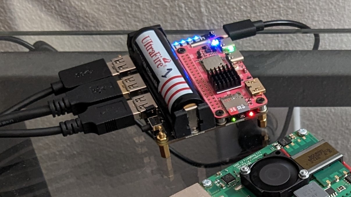

And yea, NUT-Server is a super lightweight software that will run on basically any linux distro (I prefer debian or armbian personally). It takes a little work to get set up, but documentation is abundant and the process is really not too complicated. I run mine on a tiny little pi-zero type board with a battery carrier so it is the very last thing alive in my house after all the UPS's have depleted.
