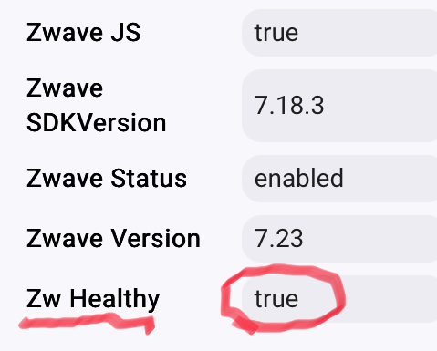

I am one of those two users. Not a fun day.
I still can’t believe how quickly HE staff reacted to it.
Well, it’s healthy!
