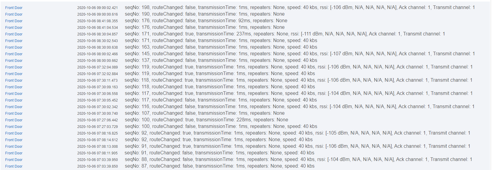

I see the same thing with my schlage lock on latest firmware. The lock does not use the repeater closest to it. instead it likes repeaters that are closest to my hub, or to directly talk to the hub. That is the other thing I have noticed is that my lock changes routes frequently. this logs shows 3 times in a couple of hours. I am not sure if this indicative of weak/bad mesh. My Zwave network is pretty sparse. One kwikset zwave lock, one schlage zwave lock, a fibaro zwave button, 1 ge dimmer switch zwave plus and one ge fan control zwave plus. Then 5 or 6 of the iris gen 2 dual zigbee/zwave plus devices.
Everything except the schlage lock is 100% reliable. I have a brand new one in the box I have been tempted to replace the original with to see if things improve. Currently I use a combination of autolock rule and periodic refresh plus lock commands to keep the door locked as wanted.
