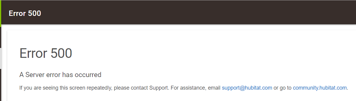

Got the container app installed, selected the Presence Central app, when I select to "Install", I get this
Sorry
Rick
Did you do anything to the presence central parent?
1st you install the container... then the parent... then the app
