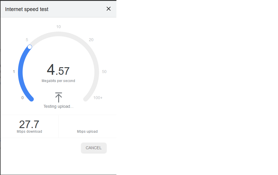

Could be coincidence or could be that the router, the firestick, and hubitat are all within like 3 feet of each other. I'm wondering if I'm having a speed issue with internet but when I do a speed test I'm fine.

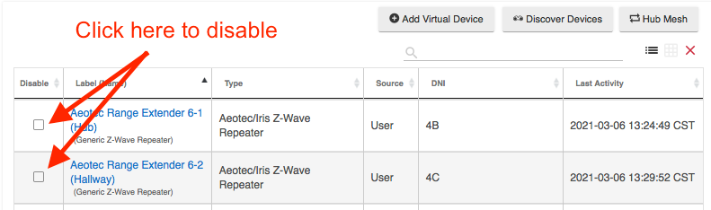

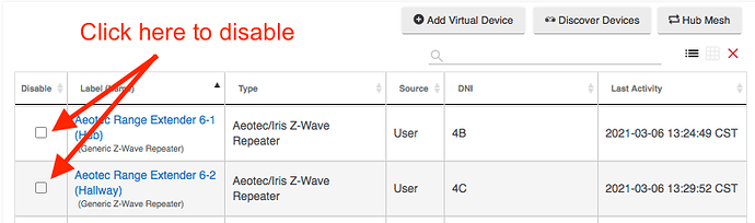

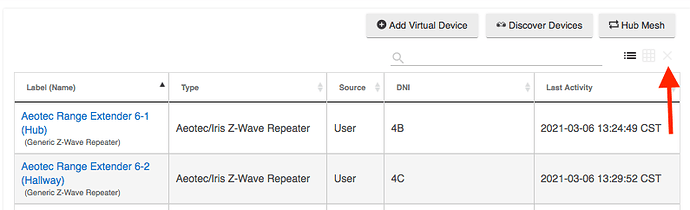

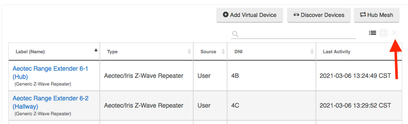

I'd recommend simply disabling these two devices in the hub (no need to remove them.) There is a feature on the devices page where you can enable the ability to disable individual devices, to keep their code from running. When you're experiencing the streaming issues, just disable both of the iPhone WiFi Presence Sensor devices in your Hubitat hub to see if anything changes.
The debug logs you've posted above indicate the devices are responding as they are meant to. BTW, I'd recommend turning off debug logging. While it has nothing to do with your slowdowns, it does mean that support will have to sift through a lot more logs to resolve any issues you raise with them.
For now, I would do exactly what @ogiewon suggested. Disable both devices during a streaming slowdown, and then confirm if that eliminates the slowdown.
This would confirm causality v/s a coincidental effect on streaming.
