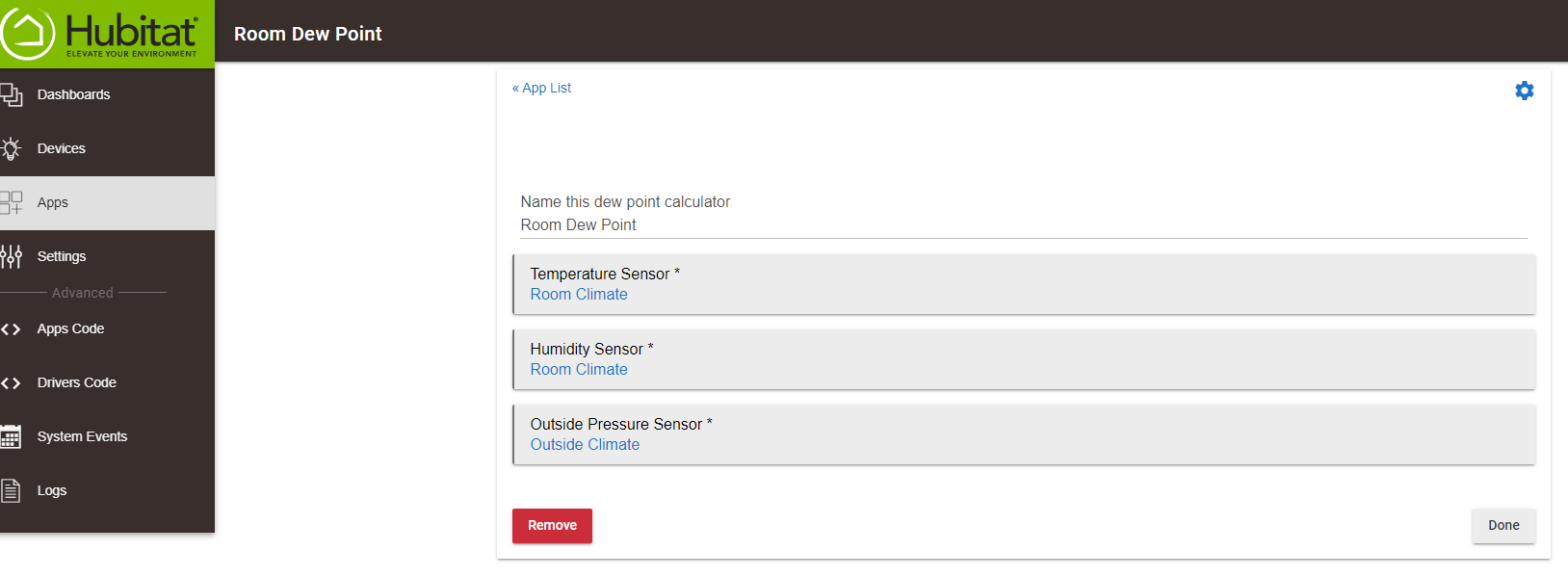

Here's a wee bit of code for calculating dew points. Based on this driver.
Absolute humidity calculation not finished yet.

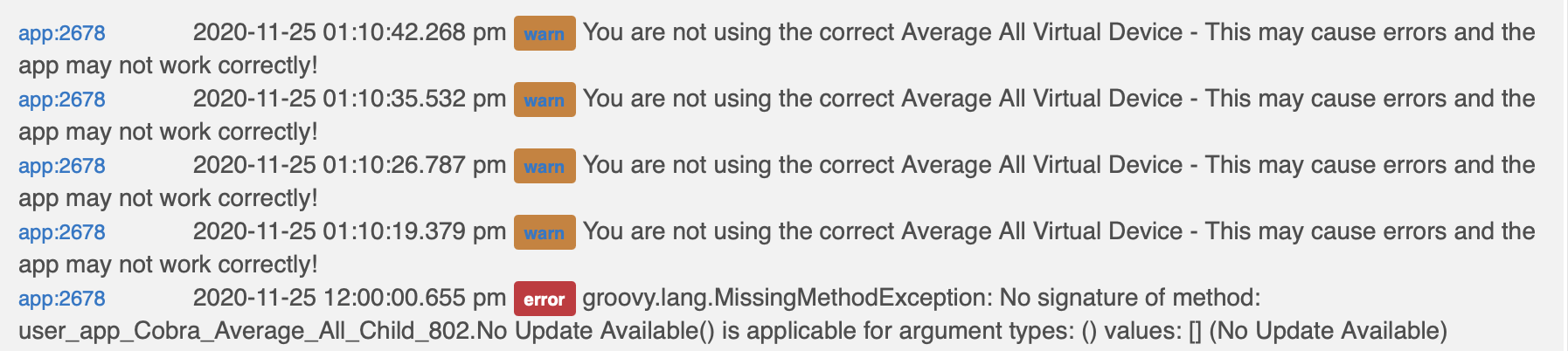

I'm getting this error and these warning any time I access a child of the Average All app. This particular group is for humidity, but I get the same thing with lux. I'm not sure what it means by "you are not using the correct virtual device." I'm using the virtual device that the app created and it has the device type "average all device."
