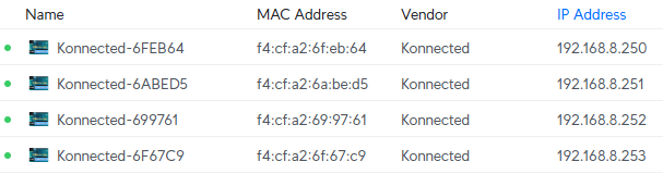

I'm moving all my smart home devices to a dedicated network. During this migration the old network and new network can freely exchange traffic.
I moved my Konnected board to the new network:
