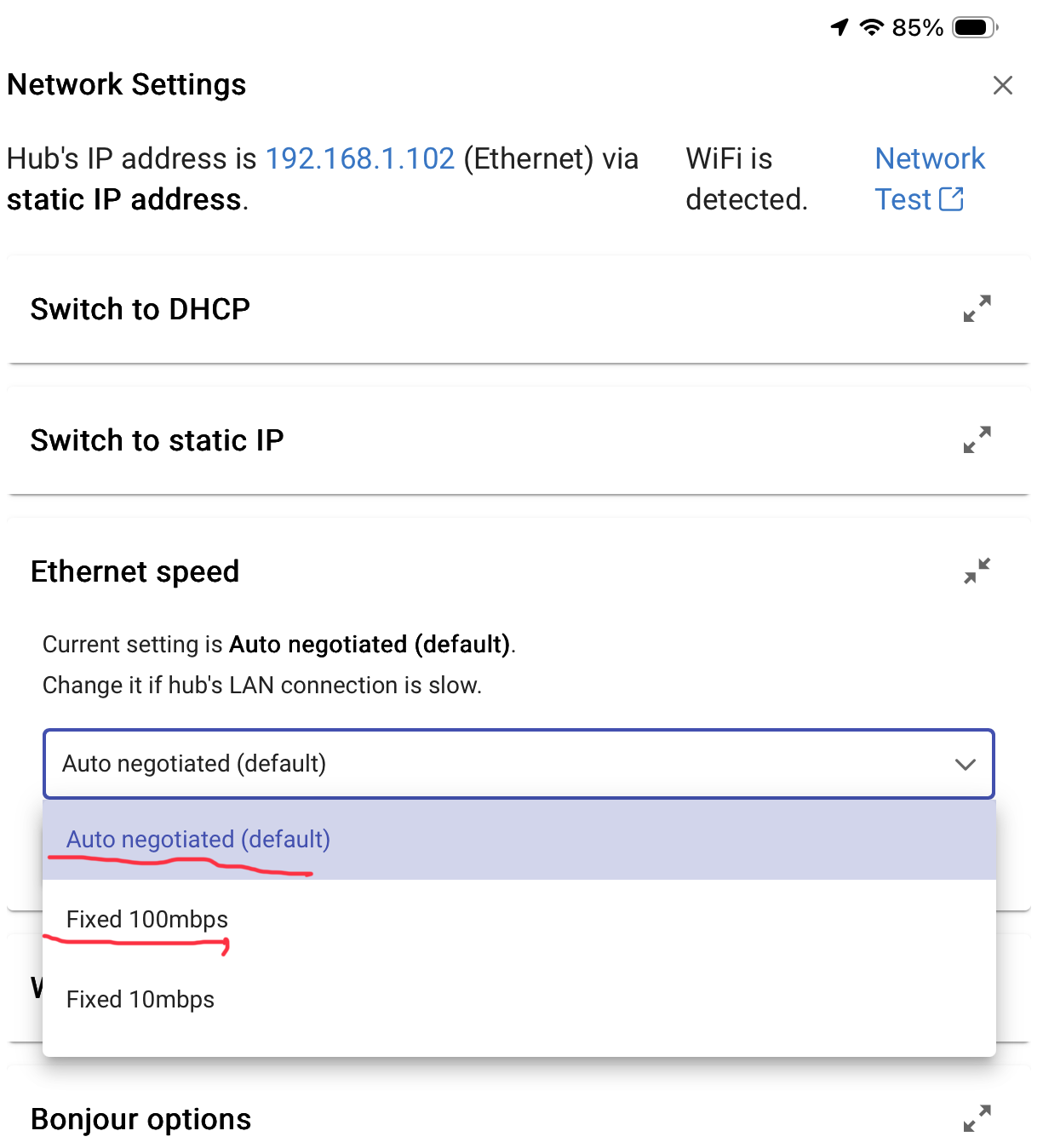

It may sound irrational, but try changing this network setting.
If yours is Auto, change to 100… or visa versa.
Well I'll be! The did the trick. I had Fixed 100mbps selected and switched to Auto Negotiated.
Thank you!
