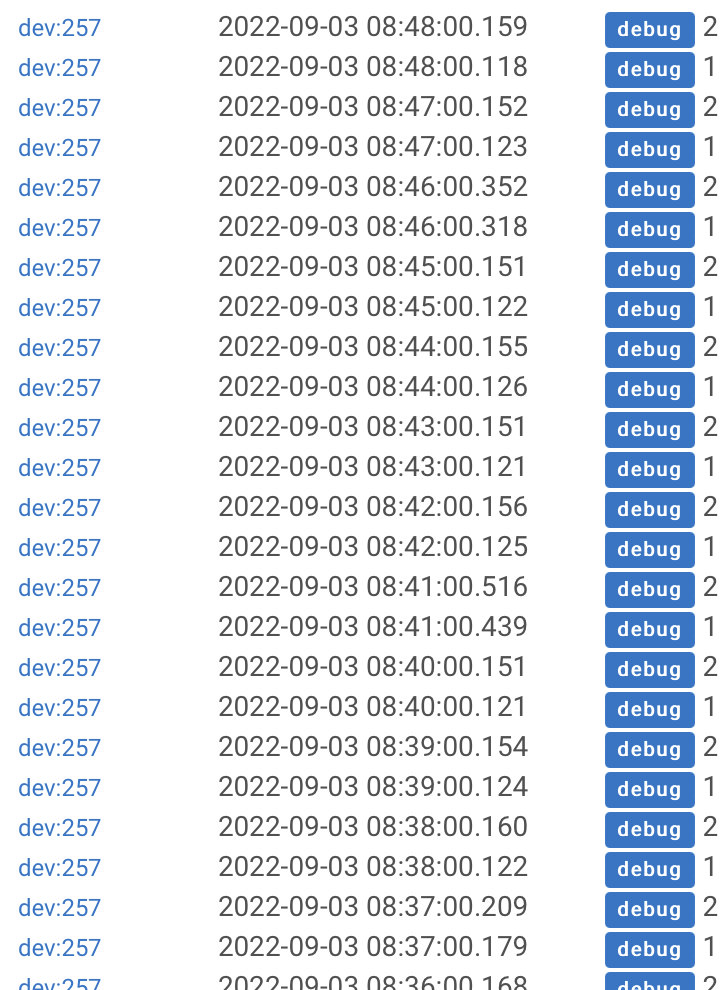

Getting masses of (annoying) unwanted debug logs for a device. As far as i can see i have "enable debug logging" disabled for this device and all its child instances.
I can only guess it might be "rule machine" creating the logs but i see no option to control debug logging in there. Any tips or advice appreciated. thanks
If you click on the blue "debug" text it will take you to the device / app that raised the log, though I would expect it to be device 257 in this case. If it was RM, then I would expect to see an "app" reference for RM on the left hand side, and the "debug" link would take you to the RM rule. That should at least clear up which "thing" is generating the logs.

A device running twice/minute with some events a few milliseconds apart, would be cause for concern. Before you figure out how to disable the logging, I would validate that the device should be firing events that often and is not some rogue device that has gone bad.

So i know its the rule-machine app running every minute but cant see how to disable debug logging for this event. Its not critical, just annoying when i want to scroll through the logs for diagnosis reasons.

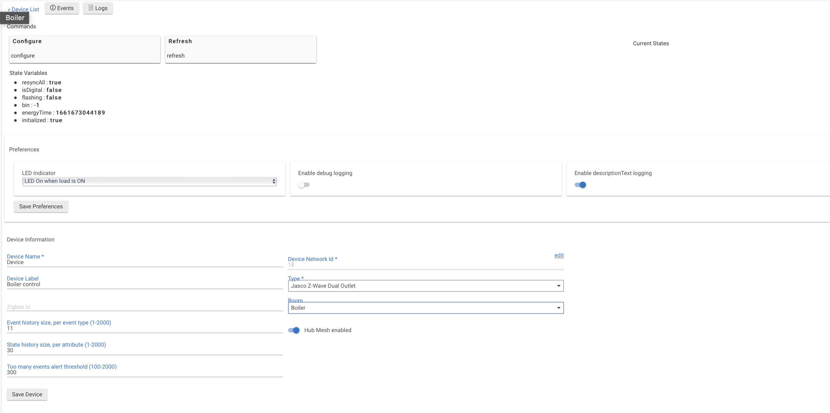

thanks. the main "parent" device has the "enable debug logging" option, as does two of the child devices, all set to off. (the child devices are 257-1 and 257-2)
There are two other child devices, which i think are effectively aliases of the two child-devices but these dont have "enable debug logging" option available and are device 18-1 & 18-2.
In case I missed it, what is the driver? A screenshot would be useful...
The logging comes from device 257. What driver is that device using?
You need to click on the blue box with the word "debug" inside it. Or in normal entries the white box with "info" in it
driver in use is "jasco z-wave dual outlet"
clicking on the blue box reveals this:
Removing extra log from next release.. Thanks
