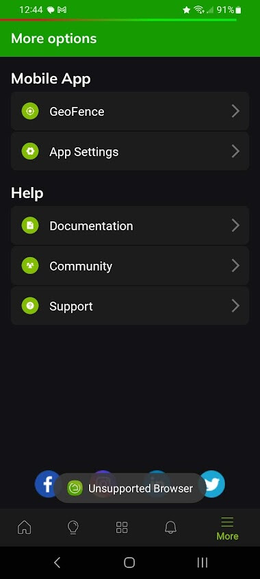

I get [Unsupported browser] from the app - android. When I click anything on this screen.

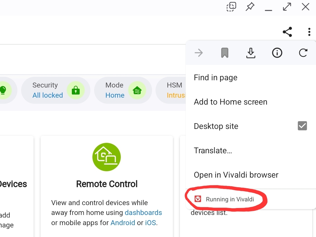

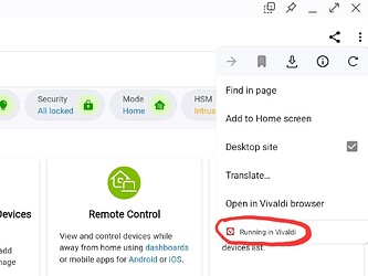

Note: You can see which browser is in use by clicking the 3 dot menu in the upper right once you connect (but if you are not connecting, that could be an issue
