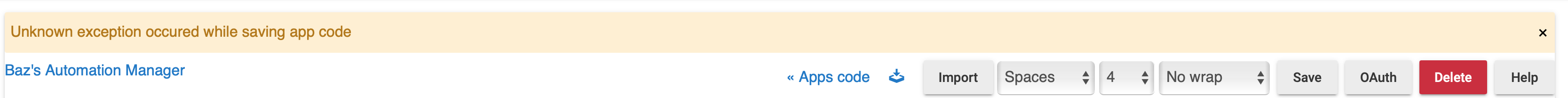

Is anyone else coming across this error when trying to save app code for a parent app???
The code hasn't changed yet I am unable to save it at all... even with only the slightest adjustments to comments etc.

It would help to see a screenshot of the error in the log (multiple lines of log leading up to the error instead of just the error is best). Also, a screenshot of the code in question.
Something must have changed because I've just reverted back to 2.2.3.148 and now I'm able to save the code again??? any ideas what may have changed to make it not save on the latest software @bravenel@bobbyD@mike.maxwell
Based on the logs, there's a NullPointerException happening in checkIfAllRequiredDevicesExist method when it's making a getChildDevice call. That call requires app instance and a corresponding id, and the app isn't saved yet. I can put a guard in getChildDevice call, but for now can you catch the exception in your code?
