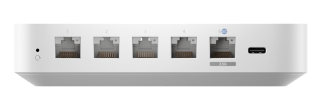

I think the UCG Ultra would be a good solution…however, it does have one limitation. While it does have a 2.5Gbps WAN port, the total combined 4 LAN ports are bottlenecked to 1Gbps at the WAN. All 4 LAN ports can communicate with each other at 1Gbps full duplex, but all 4 ports share a 1Gbps connection to the “router” side of things.
Thus, the 2.5Gbps WAN port is really not very useful, compared to a 1Gbps WAN port.
So, if the priority is to achieve faster than 1Gbps WAN speeds, the UCG Ultra and the UniFi Express will not be very helpful.
The UniFi Gateway Max has 4 x 2.5G LAN ports, and a 2.5G WAN port, but it does not run the UniFi Network App. You’d have to self host it, or buy a CloudKey to run it.

Hadn't looked at this before...cute little bugger, about the size of a coaster. :slight_smile:
