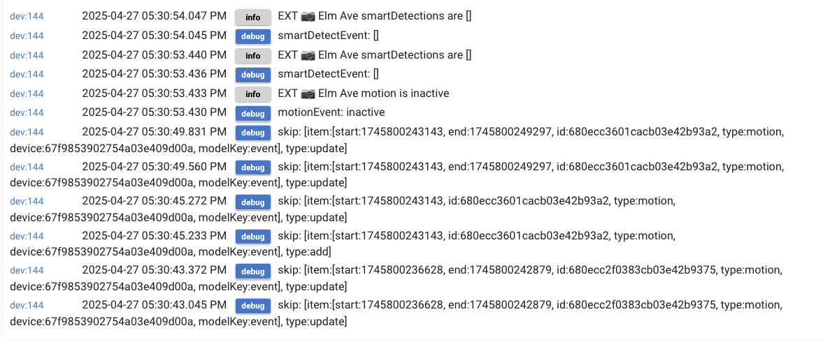

I have not see any of this data come over the API myself, but if you enable debug logging on the NVR and camera device (the camera is probably enough unless the data is different enough from the rest that it's not making it that far), you'll see the "raw" data coming in. If anything there looks promising to distinguish, please share it, either here if you feel comfortable or in a PM with me if not.

I have two distinct smart detect zones setup (default, Test Zone). Unfortunately, I don't see any reference to either. I don't know if I can dive deeper into the data/API.

If you have debug logging enabled on the Protect Console (or NVR) device on your hub, there isn't anything deeper -- that's all the data it's sending.
Most of that should make its way to the camera, too, which it looks like is where you were looking above, but the console/NVR device might have a bit more. If it does, there's no guarantee it will be what you're looking for, but it's about the only other place you can look.

Oooh, debug on Protect, not the Hubitat Protect integration. Let me look at that.
I'm not finding the bits I'm looking for. That's too bad as this integration is providing so much. It would be so easy if Protect passed the zone information as well. I'll have to suggest that to Ubiquiti and they might add it in a few decades. :wink:

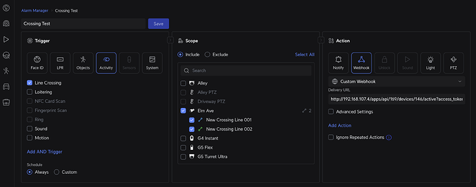

I still wish zones were reported, but I can work with crossing lines. If anybody else is interested, I first setup an alarm in Protect.

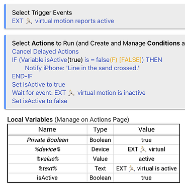

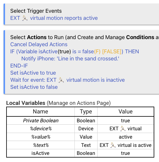

Then I setup a virtual motion sensor with "Auto Inactivate" set to 30 seconds. This is to mimic the behavior of my PIR sensors. Finally I setup a Rule Machine rule to send me a notification.
I use the local variable isActive so that the routine only sends me one alert if the rule is triggered before the sensor resets. Oops, I see I can remove the "Cancel Delayed Actions" from an earlier iteration.
