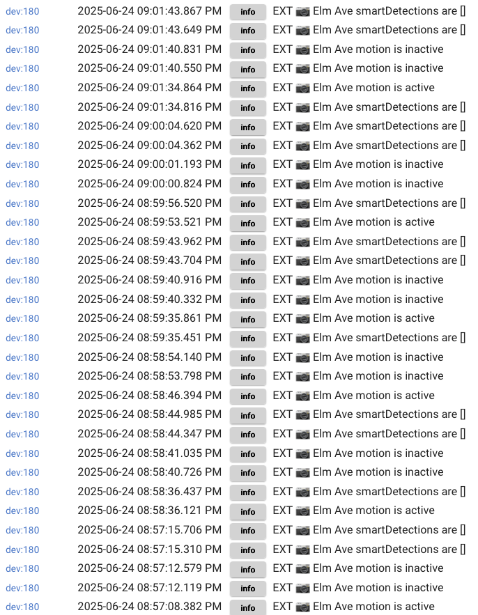

Over the last day or so Protect smart detections have stopped working.
HE gets the motion active/inactive events as well as the end smart detection events. I don't see any of the trigger events.
Has anybody experienced anything similar?
C-8 Pro, 2.4.1.177
Protect, 6.0.41 (updated on the 19th)
Everything was working perfectly until yesterday. I'm checking the UI site as well, but haven't turned up anything yet.
