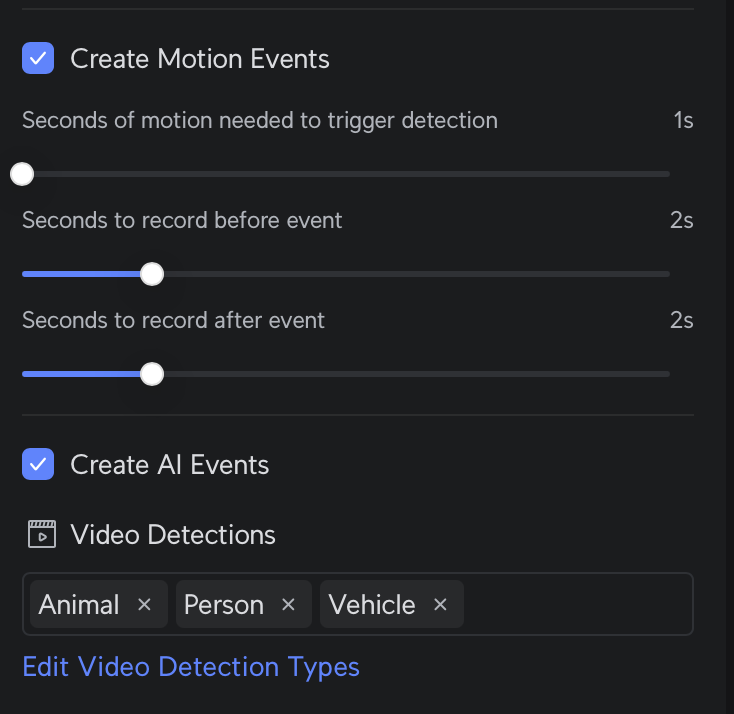

I imagine this is due to the motion configuration for the camera.
The trigger threshold has a minimum of 1 second. What is interesting is that the AI detection is faster than that. Is anybody aware of any further settings that may impact the motion alert sensitivity? I am currently testing one G6 Turret, one G6 Bullet, and two G5 PTZ cameras.

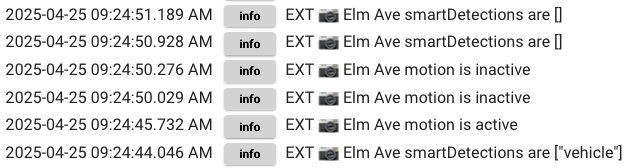

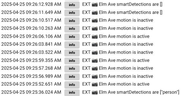

In this example, two people were walking and didn't stop. As you can see the motion flipped back and forth between active and inactive several times.

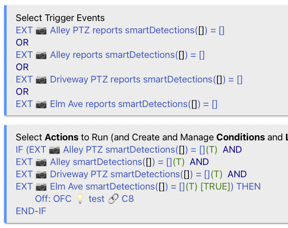

None of this is a real issue. I am currently testing the new drivers to see how useful the events are. The only real pain point so far is the missing or lagged motion events. I can't setup a rule that uses "when all motion stopped" as a trigger. I can use the AI events something like this:
It works but is a bit unwieldily.

It is definitely a threshold in Protect. I was curious if anyone had found other settings that might impact the sensitivity. If it was or became a real issue I would hit up the Unifi forums. I wanted to see how others were using it in HE.
For testing I have one light that I'm turning on when any of the four cameras detect motion. Motion events are multi-select and custom attributes are single-select. This is why I have the odd trigger and conditional in the above sample.

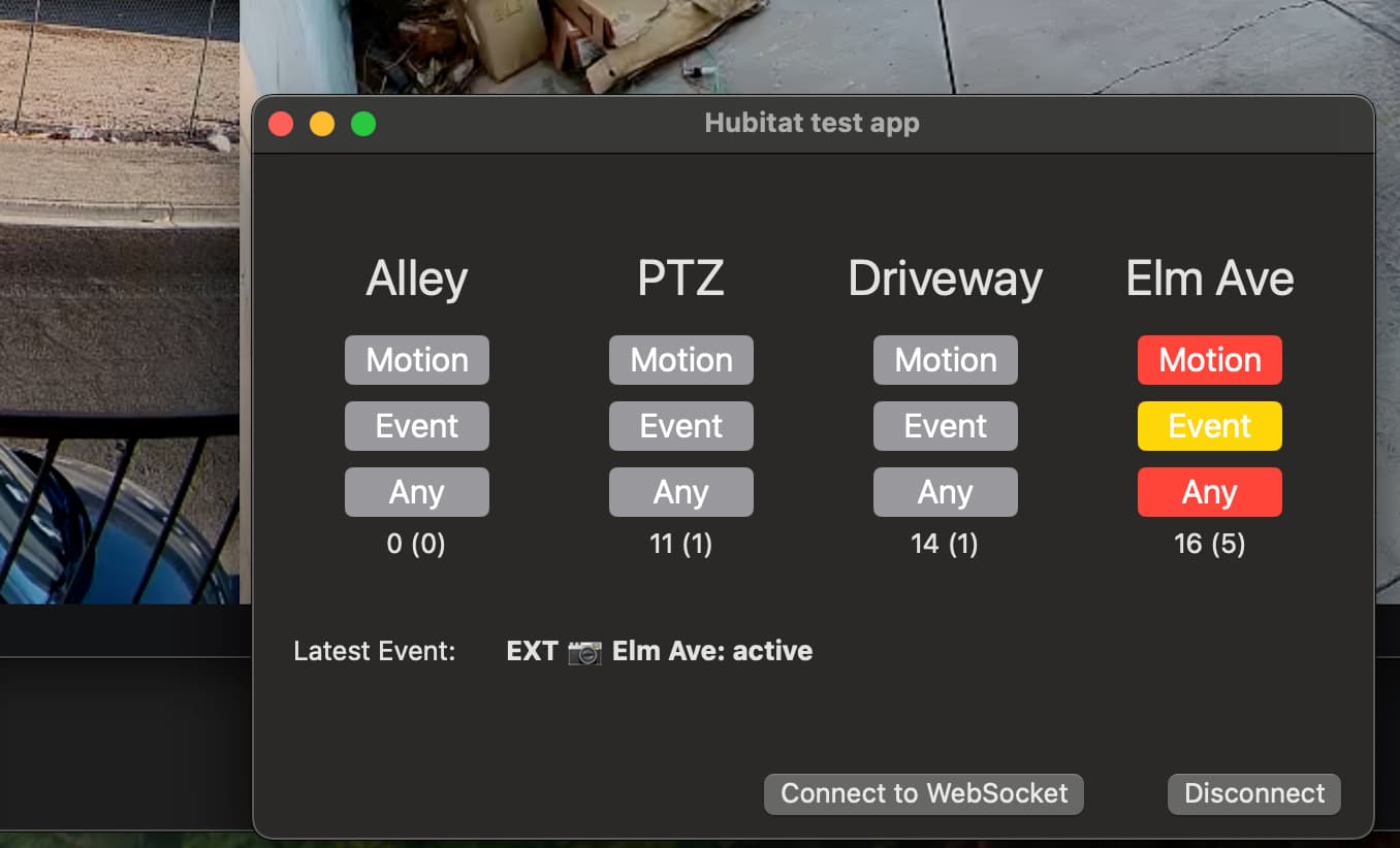

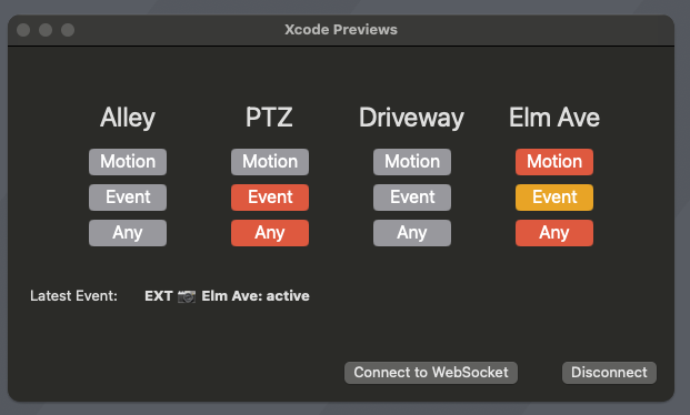

So I had a bit of fun and created a simple app to monitor the cameras in realtime. It is listening to the event web socket.
Motion turns red when the driver reports active motion. Event changes based on event type (Person: red, Vehicle: orange, Animal: green). Any turns red on any motion or event.
It is interesting to see them like this. I have found that motion is not very reliable. I see a lot of motion events that don't get reported. When there is a motion event it will typically stay active slightly longer than the smart detection. It also tends to go through several active/inactive cycles per event. Combining the two gives the most consistent detections.
Should the driver combine the events? I'm not sure. It would make some rules easier. At the same time it would reduce the flexibility. Regardless, it was a fun experiment and helped me with my Swift programming. :slight_smile:

The detections are, interesting, to say the least. The camera that gets the most traffic is a G6 Bullet. When a car goes by I always get a smart detection but sometimes won't get a motion detection. Then when there is a motion detection it often will toggle between active and inactive a couple of times.

I've added counters for total and person triggers.
The counters are based on the Any detections so the counters don't get inflated by the erroneous motion events.
