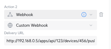

In your "Delivery URL" for the webhook settings, just provide the right endpoint. For example, you could create a virtual button and make Maker API push button 1 on that device by doing something like this — though get the actual token, app and device IDs, etc. from your Maker API instance:
http://[hub_ip_address]/apps/api/[maker_api_app_id]/devices/[device_id]/push/1?access_token=[access_token]

UniFi Protect settings with above settings

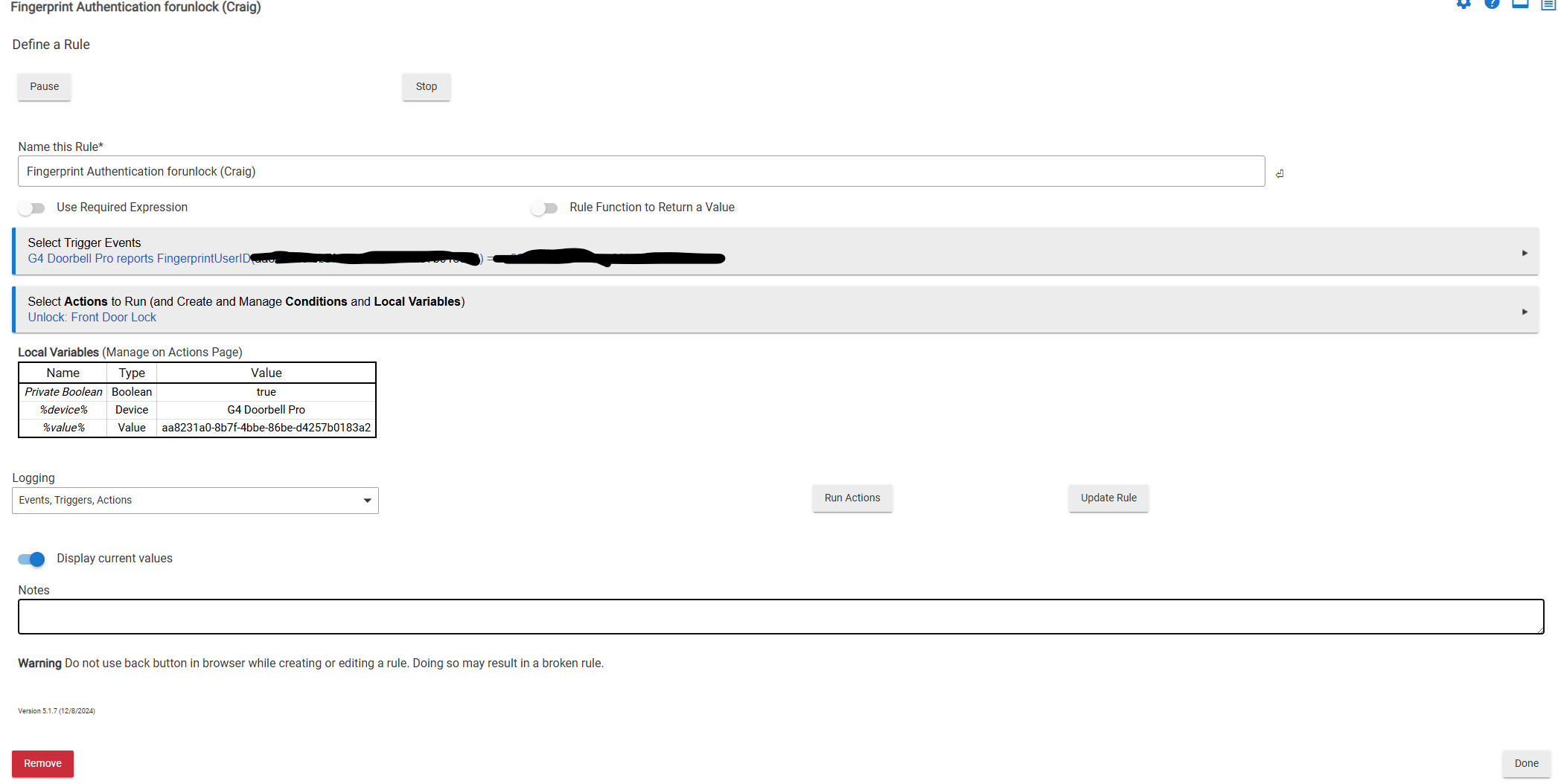

Well @snell pointed out how to do it. Here is the rule I have using his integration.
It isn't hard to do, the problem is that it isn't easy to identify what the unique UUID is. That will take testing it and then tracking it yourself.

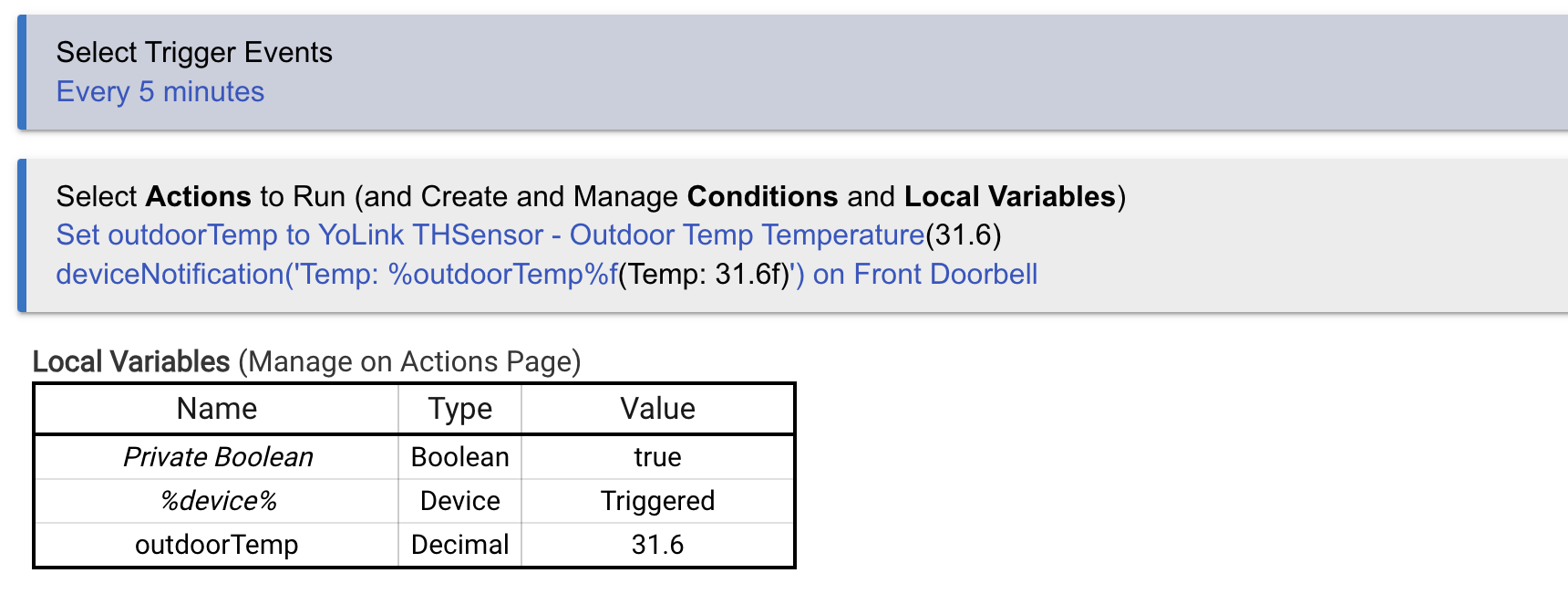

@snell Can your driver push data to the screen on the doorbell? I had a rule with the tomw driver that would take a changed temp from an outdoor yolink sensor and then display it on the doorbell screen. I tried using the "push" option, but that doesn't seem to work.

Yeah, I'll test it. The tomw driver supports the message to the display. The only problem is that the stupid doorbell doesn't honor newlines, so it just wraps stuff randomly. I'm just displaying "Temp: xx.xF" on it, so not a big deal.

Websockets are enabled, but still not getting Fingerprint messages from the doorbell. The new driver doesn't error out or anything when sending a notification message to the doorbell. But, it does not update the display. I tried both through the commands menu, and by updating my rule that updates the display with the temp:
