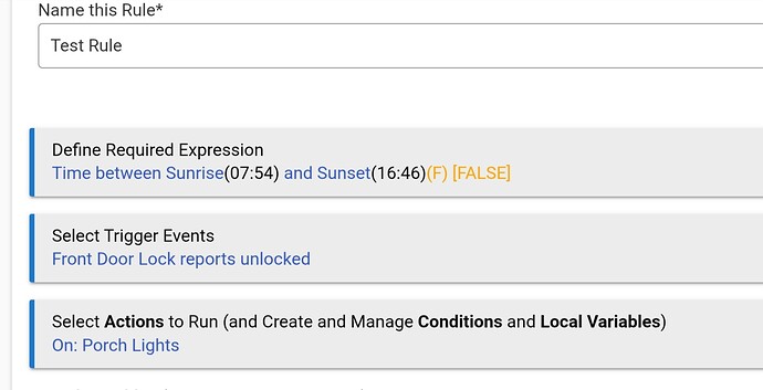

I went to create a rule with a condition (sunrise/sunset - not a specific time of day). The condition was "false", and when I went to create a Trigger I could not - I had to go and make sure the condition was "true", then I could create the trigger. This is not what I would expect - I should be able to create a rule whether the conditions are true or false.

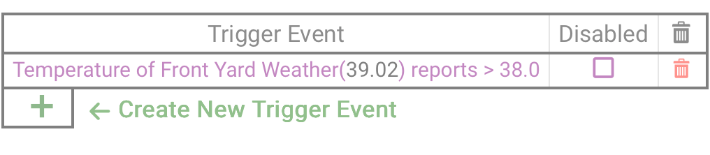

From your description, you are trying to do something similar to the following screen capture. And as you can see, this is certainly not a problem.

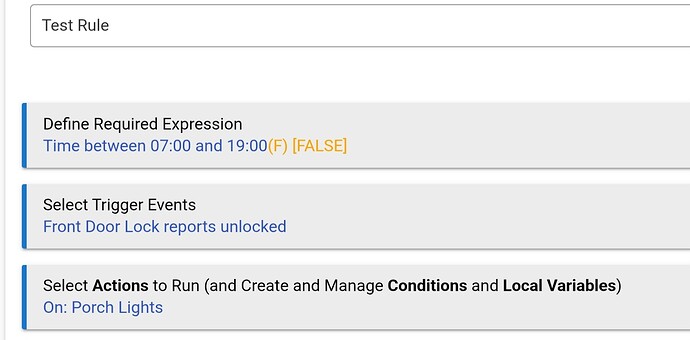

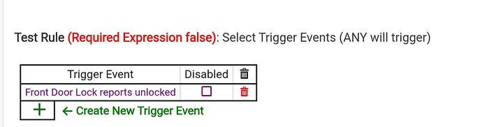

I cannot create a new trigger (second screen).
Once the expression is "true", I can.
No error, just no ability to add a trigger.
Possibly a sunrise/sunset issue? I did not think to try that.
Seems to only happen on a sunrise/sunset conditional. I updated the original post to reflect this.
I am not experiencing the same thing.
It's odd that your "actions" window says disabled across the top. It doesn't really resemble my screen.
Edit Sorry I was looking at actions and not triggers.
When I exited the rule and went back into it I saw the triggers were dimmed out as your image shows. Then I realized that it was still in the trigger entry mode.
When I clicked on "cancel this trigger event" I was able to create a new trigger.
Perhaps it's possible that when you returned to the rule after adding the first trigger you were still in the data entry mode.
Nope. I could not even enter the first trigger without changing the conditional.
