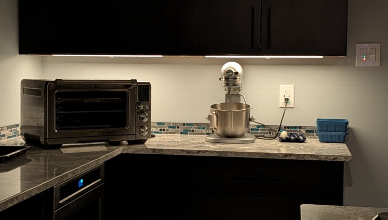

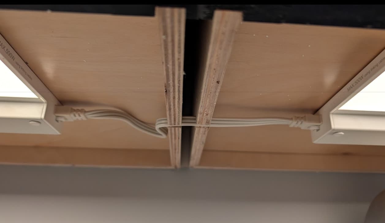

We just added 3 Cync lights during a kitchen renovation, one 12" under a corner cabinet and two 24" ones under two 33" cabinets. They seem well-made and have been relatively reliable on my IOT WiFi. I like the fact that you can link them up using the provided power cords, so we hard-wired one of the 24" ones and daisy-chained to the next one (just be aware you have to go right-to-left when doing that). They can do 2000K to 7000K in color temperature mode, which is a wider range than any of my other devices.
This picture was intentionally taken from a low angle so you can see the lights. If you're average height, they disappear under the cabinet edge.
The one on the right is hard-wired. The one on the left gets power from the first one.
