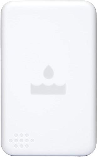

Anyone know the trick to pairing a C5 to Fibaro Water/Temp Sensor (FGBHFS - 101)?

Wait a minute. Isn't this a BlueTooth device?
it has z-wave inclusion/exclusion instructions all over the documents but I wonder considering how much phone app instructions there are as well
I just checked:
The FGBHFS-101 is a Bluetooth sensor that is HomeKit compatible.
The FGFS-101 is a z-wave sensor. Get the ZW5 version. It is z-wave+. The ZW3 version is only z-wave.
Uhg, I'm sure you're right! I'm not familiar with the Apple Homekit so just assumed it was also z-wave setup to!? Now that I scrutinize the packaging a bit more there is bluetooth symbol and no mention of z-wave which is usually on the packaging somewhere.
Ok this solves the problem, I'm a dope:(
Thank you!
