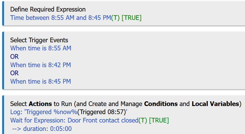

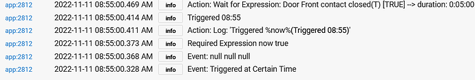

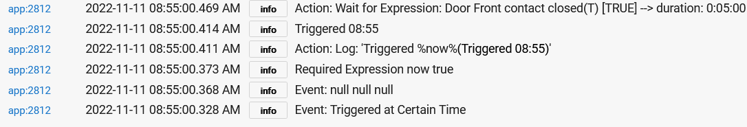

@deserthillsdrive post a screenshot of your rule and turn on logging. It is possible that the required expression is evaluating true after the rule tried to trigger at sunset. I checked it with a certain time before posting that example and it worked as expected. Perhaps sunset is different? My suggestion would be to change the restriction to sunset -1 minute or the trigger to sunset +1 minute. The logging will show how many milliseconds after the required expression and the trigger are happening to see if this is the issue.
Edit: I just updated and reran my test rule and you can see that the trigger is happening before the the required expression evaluates as true but the actions are running.

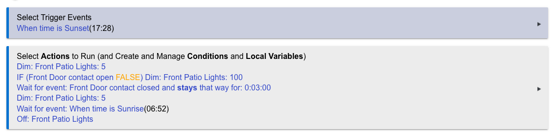

I posted a 2-rule option that is similar if you want to try it. The only difference is an extra 5 seconds on the off command.
I have turned the logs on and will monitor them for tomorrow morning. I set up a simple rule to turn them on. Everything else was working requested.

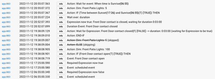

I think everything worked as it should have tonight. Here is a screen shot of the logs.
I'm glad it's working. I have a though how to make the single rule work if you're interested in trying it again.
Those logs don't show the rule firing until the door was opened at 19:38. It does not look like the rule turned on the porch light at sunset.
I believe deserthillsdrive is using a two-rule approach now.

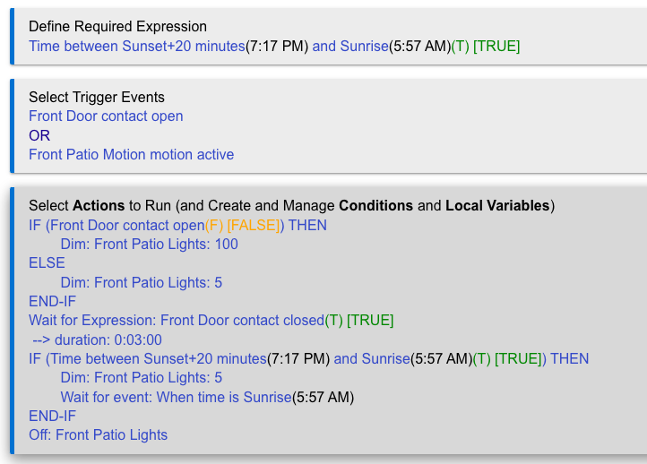

Hi there, I have decided to add a motion under my patio for my front door to trigger the lights to come on without the door needing to be opened first. How do I integrate this into the above-mentioned rules. I have tried a couple what I thought would work ideas with no success.
Using your posted rule, I'd add the motion sensor like this
IF (Front Door contact open OR Front Patio Motion motion active) THEN
Wait for Expression: Front Door contact closed AND Front Patio Motion motion in active --> duration: 0:03:00
Notice the IF is using OR so either event will turn on light. The Wait is using AND so both states must be true for the 3 minute duration to advance to the next action.
I'm not sure that the ELSE is doing anything unless your calling the actions of this rule from another rule. If you're not then you can probably eliminate the IF-THEN-ELSE and just leave the Dim: Front Patio Lights: 100. The logic, though, looks like it could be setup for use with a time trigger, too.
