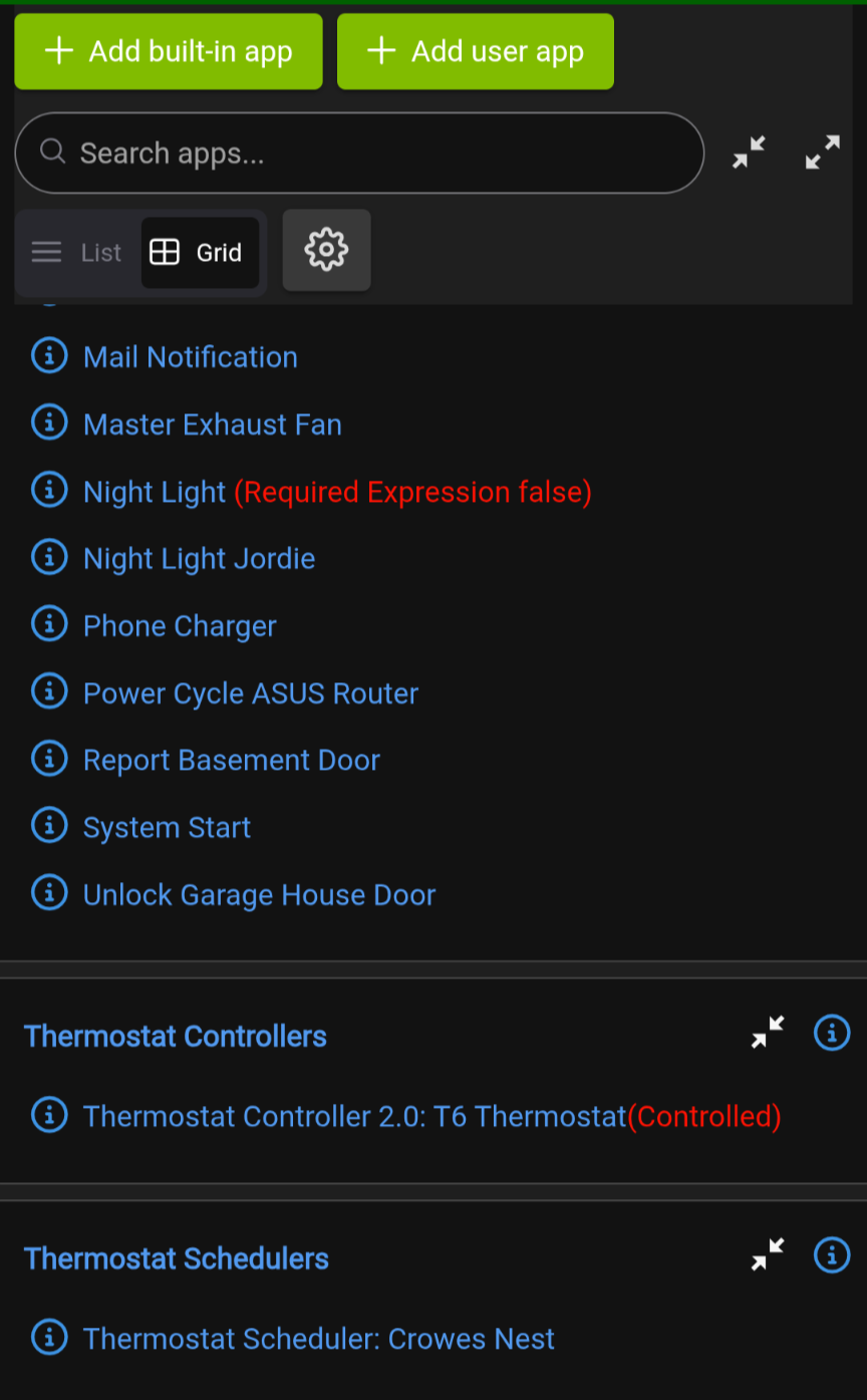

I tried Thermostat Controller with the T6s, and it literally took over the thermostats so I could no longer use the physical thermostat controls on the thermostat itself to change setpoints or anything else, as it locked the screen controls. Not what I was looking for.
Thank you, I'll be sure to check this out. I currently have a schedule working using the Thermostat Scheduler app.
Thanks I should be able to post pics now.
