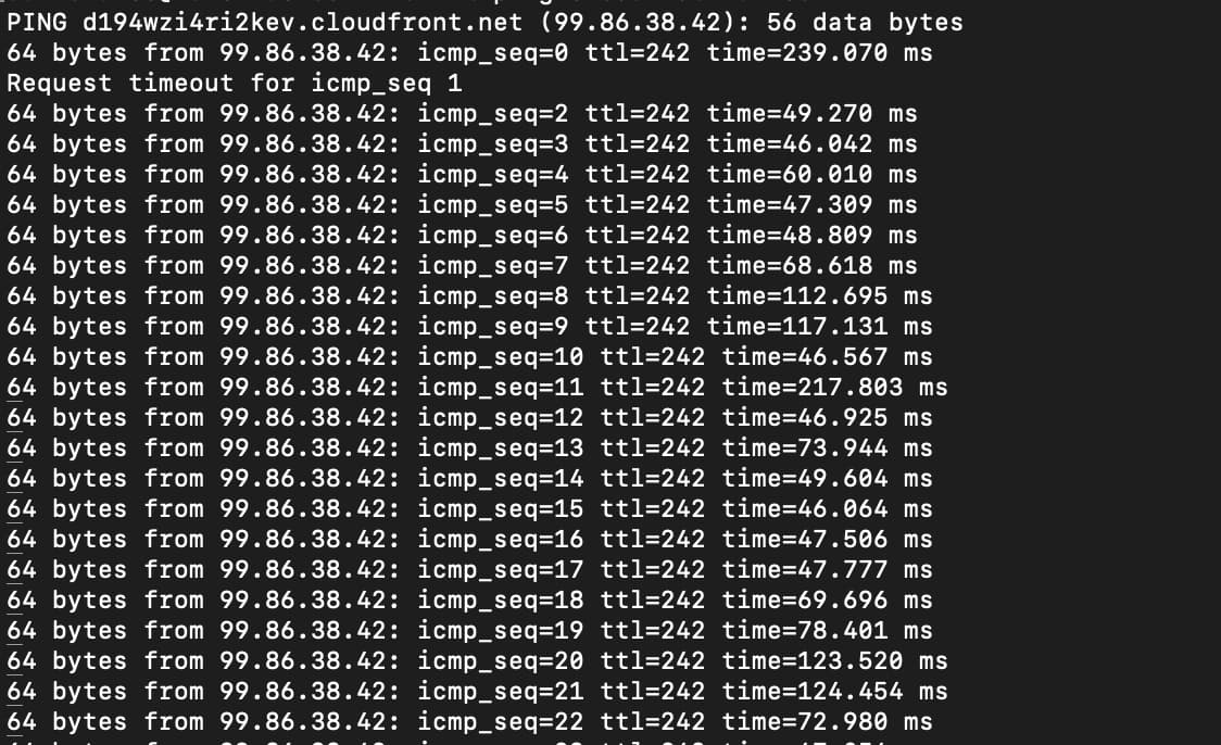

And..... as suspected.
That is a ping from a PC.
Did you read my instructions and see my example?

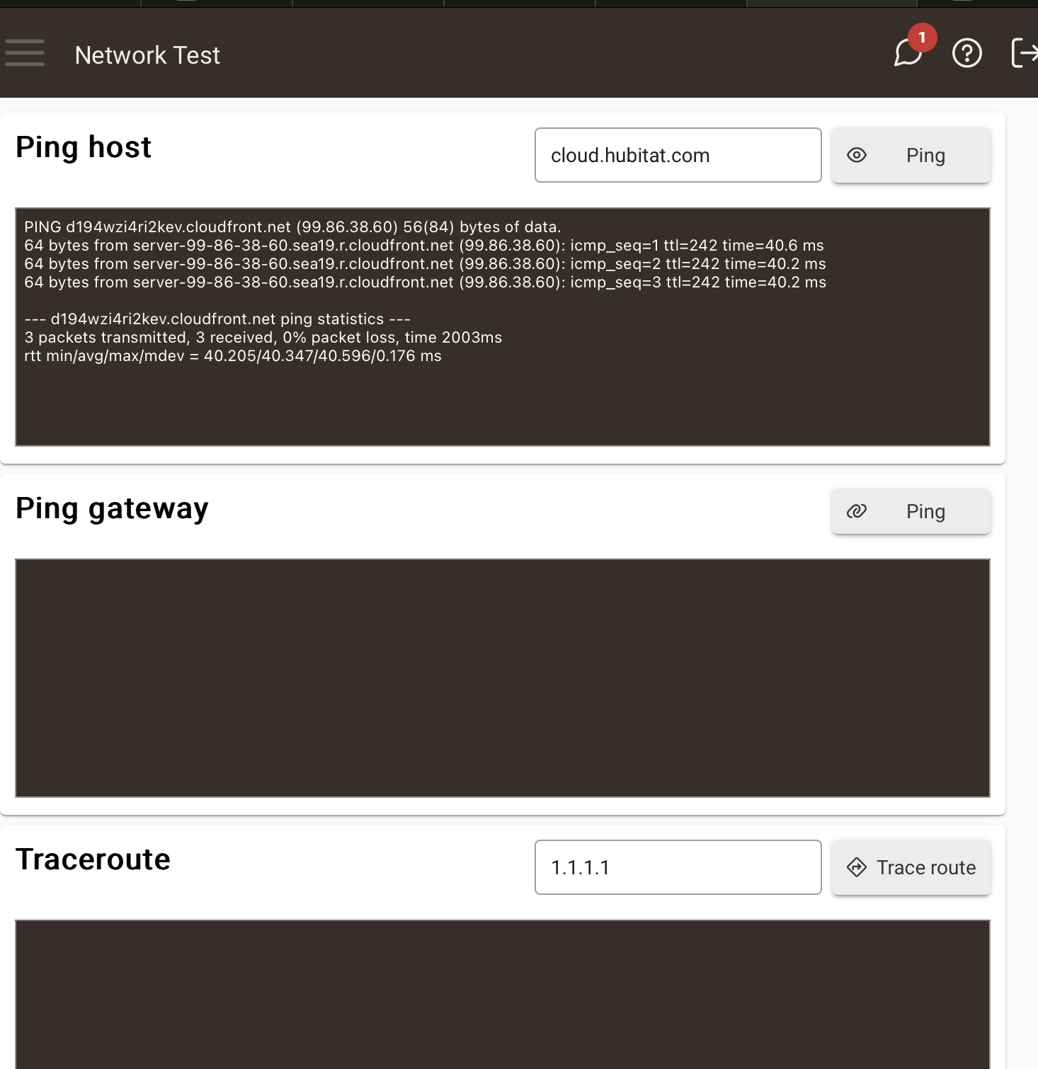

This is to be done on the web UI for the HUB
Looks like this:

got a failed, checking network setting...
Take your hub out of your private VLAN. The hub has obviously been walled off from the internet. Or it has been walled off from accessing a DNS server.
Does ping work from the hub if you try 1.1.1.1?
Yup need to know this too. I gave specific instructions because both ping tests tell us different things.

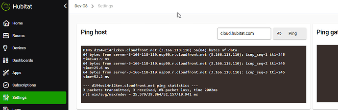

Something is awry. You have some old cached DNS data. According to what I can see, cloud.hubitat.com should resolve to these IP addresses:
host cloud.hubitat.com
cloud.hubitat.com is an alias for d194wzi4ri2kev.cloudfront.net.
d194wzi4ri2kev.cloudfront.net has address 54.230.31.112
d194wzi4ri2kev.cloudfront.net has address 54.230.31.104
d194wzi4ri2kev.cloudfront.net has address 54.230.31.27
d194wzi4ri2kev.cloudfront.net has address 54.230.31.106
Thats a beta version, FYI. Please read the release notes.
It is possibly location based on what IP's you actually get for something like this. Mine was totally different as well.
Oh yeah - didn't consider that!
