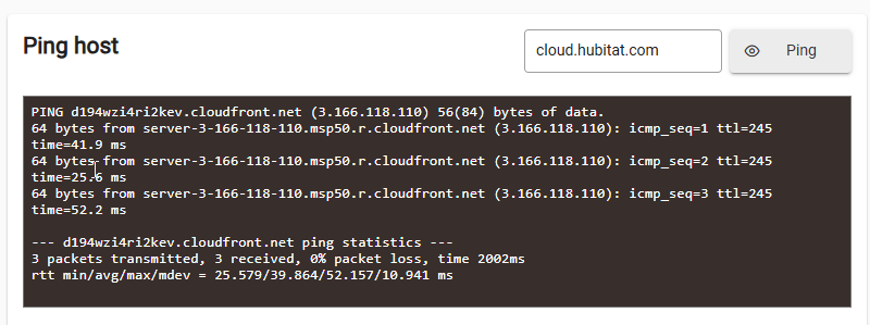

Go to settings > Network > Network Test
On the ping test, try to ping an external IP and also a domain.
Try 1.1.1.1 which is the default.
Then also try cloud.hubitat.com
Post a screenshot of the results.
Example:
checking...

no problems pinging cloud.hubitat.com

Make sure you ping or traceroute cloud.hubitat.com from your HUBITAT hub. And post screenshots of the outcome.
